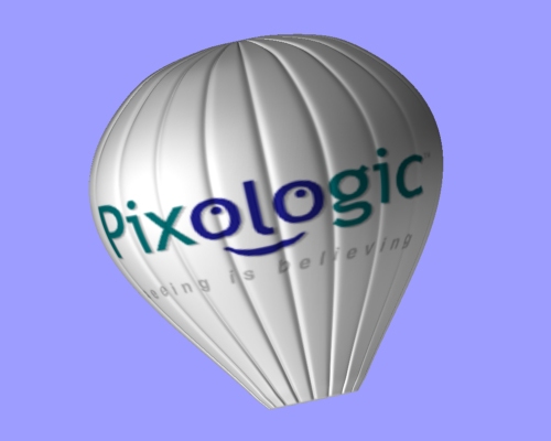

Like this:?
http://www.zbrushcentral.com/zbc/showthread.php?t=25016&page=1&pp=15&highlight=balloon
Lemo
About 10 minutes with the Curve Profile tool, column masking and then deformed with the inflate and smooth tools. Any texture can be applied and it will follow the contours. Try starting with the bamboo tutorial in the Practical Guide and it will explain about the masking. The seams in the cloth could also be added the same way without much effort.
