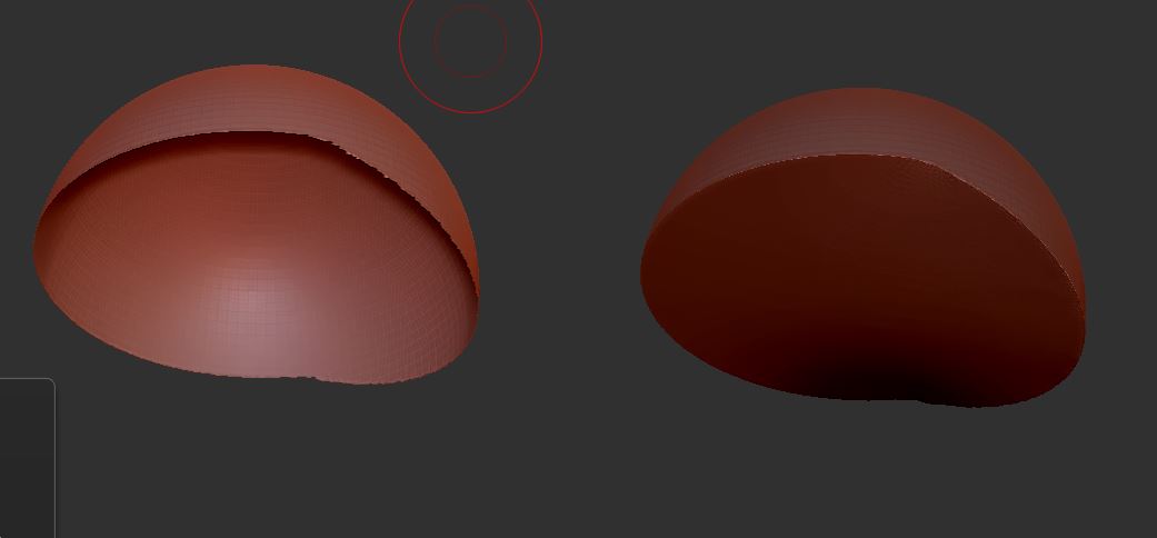

I have a small problem with the Dynamesh when I cut an object in two part with slice curve, the two sides are cut hollow but then I’d like it to be full.
Anyone know if there is a button that I would support that would avoid me to do a “split hidden” followed by a “close holes” every time?

See in the attachment; on the left; what I have, on the right; what I would have.

I think this is the Droid you are looking for… and yes, this did change in version 4R6.
If you click ‘Auto Groups’ in ‘Tool > Polygroups’ before you do a split, it will split the section as one piece, closing the hole. So, the flow would be…
  1. do your slice.
  2. DynaMesh with ‘Groups’ on, ‘Project’ off.
  3. ‘Auto Groups’ in ‘Tool > Polygroups’.
  4. ‘Groups Split’ in ‘Tool > Subtool > Split’
edit: added paths to Auto Groups and Groups Split which I didn’t do the first time.

It’s working good with “autogroup” button.:laughing:
I just don’t find “group split” button! Do you mean “split hidden” in subtools panel ?
Thank everyone reply on this thread!:+1:small_orange_diamond:D
Split hidden works if something is hidden ;). You can also split groups if you’ve cut up your tool.
‘Groups Split’ in ‘Subtool > Split’
Yep thanks!!:confused:
