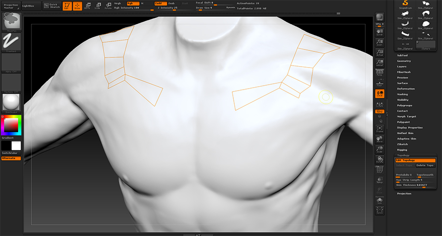

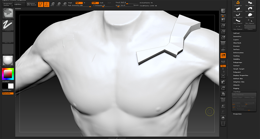

I am trying to teach myself how to use a Zsphere to create new topology. My initial subtools have come out just fine until now. I am creating a shoulder piece, but whenever I preview the adaptive skin, the right side has the correct height value, while the left side is inverted.
Edited topology:
And the resulting adaptive skin:
I’m sure I’m missing something very simple here, but any help would be much appreciated.

Sometimes with Symmetry On the Retopo doesn’t work properly. I get around it by doing half of the retopo and using Mirror & Weld.
Thanks dillster, I thought it was me. I’ll just do the m&w.
-GG
