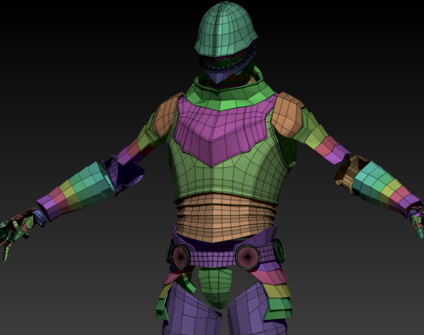

Hello, i’m currently struggling a lot with my workflow. I think i’m almost at the last step (texturing) but first i want to add details to my sculpt. I did all my hard surface stuff on Maya for all the armor pieces while keeping in mind the topology i wanted it to have so that i could sculpt without problems. but when i subdivide a piece (at 1mil polys) it still looks pixelated if i add details.
So, what process should i follow for detailing my armor?

  • You’ll also want to make sure your topology is suitable for sculpting. The optimal topology for getting the best results in ZBrush is evenly distributed quads, as close to square-shaped as possible. The topology in your picture looks pretty good, but you might want to retopologize any areas where the polygons are too stretched or oddly shaped. ZRemesher may be useful with this.
  • Keep in mind that when subdividing a mesh with hard surface elements, it often requires Creasing to keep edges hard when being subdivided from low poly. Your mesh looks like it already has some creasing, but more may be required to keep certain pieces from becoming too soft when being subdivided.
