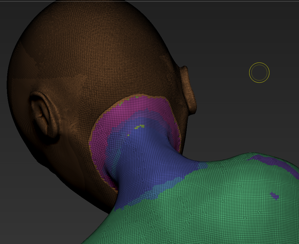

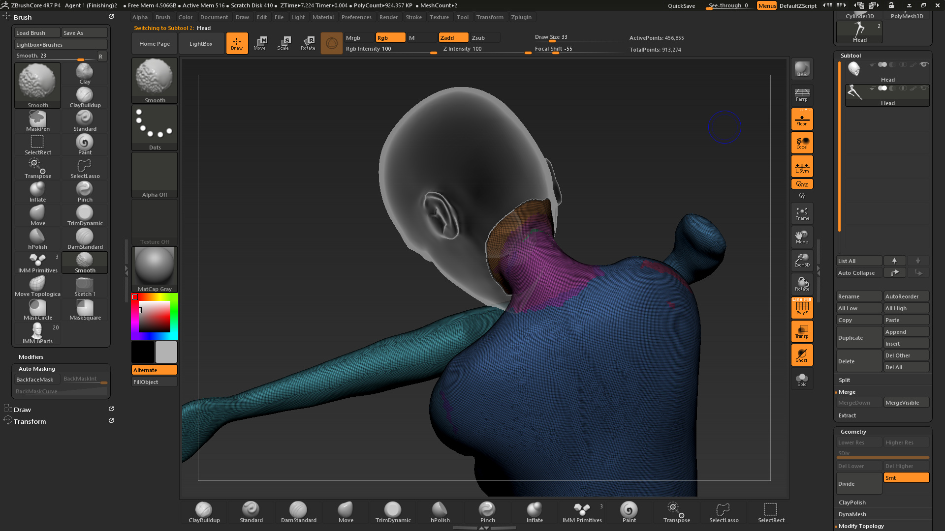

As you can see in the attached images, the figure I’m working on requires two separate mesh resolutions be welded together…but damn if I can find a way to do so. Specifically, my issue is that the face and head require a much higher resolution than that of the body (not that I’d be OPPOSED to upping the body’s resolution, but ya know, ZbrushCore and it’s limited polygon counts… >.< Never expected that to be an issue but, here I am, and it apparently is lol.)

dividing the head, neck, and body into separate subtools, manualy dividing the gemoetries to be roughly equal, and putting them back together. This did not work at all. Dynamesh welds to the lowest poly count, apparently? and/or it is artificially limiting me to some ‘max poly count’, because the head ALWAYS loses it’s definition.
welding the head on as a separate subtool to the neck and body… this again lowered the definition on the head drastically.
Where I’m at right now, which is I lowered the res on the head, attached it, went back to the high-res head, copied it, and tried paste/replace and paste/append to replace the low-definition head mesh. This is where I’m stuck right now. As you can see, this did not, sadly, actually replace the geometry…it just pasted it over. sigh. So when I delete the low-res head, I’m left with a cap between parts. No solution at all, really lol.
