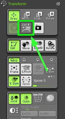

Hi @Zoda Welcome to ZBrush Central
The “Edit Spotlight” button is in the “Transform” palette. Just assign the Z key to that button.
That worked. Thank You!
