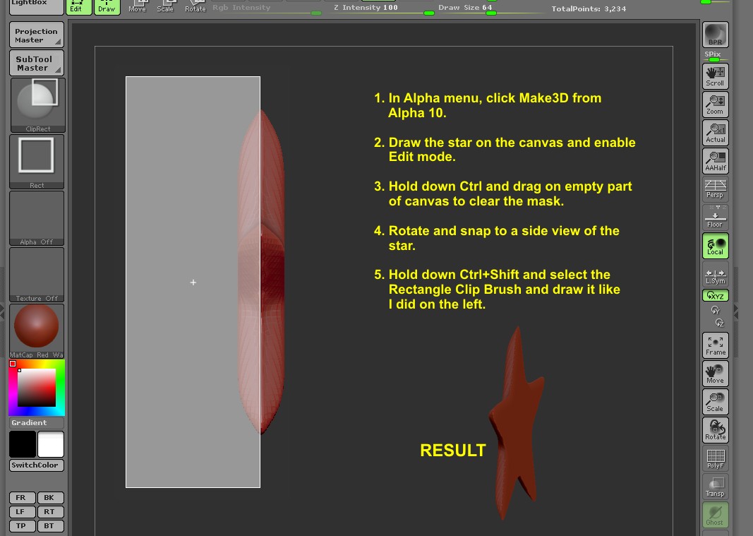

Thanks a bunch! Works a charm!
As an aside, your step 3 also fixed my Deformation -> Flatten problem. I didn’t realize part of the Make 3D process was applying a mask to the object. Once I cleared the Deformation -> Flatten worked as expected. Cheers!
Your welcome, and yes I knew that that was your problem but I thought I would show you an alternate and quicker way to do it. Also. if you ever Extract, make sure you clear the mask on the extracted object. You can usually see the mask in the Subtool submenu. Happy ZBrushing!!:slight_smile:
