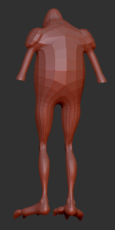

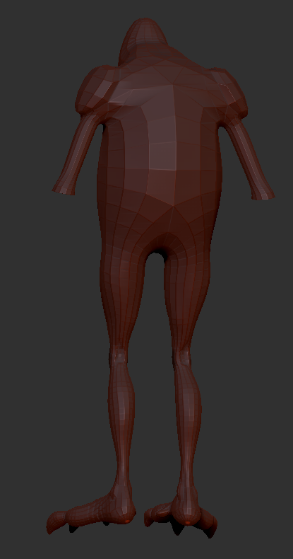

Hello! I work and suddenly my model became darker (see pics). So i made 1 step undo, and model became lighter. I am trying to understand what is this. I think that if i will see maybe somthing like log of undo history, i can understand what was that.I’m sorry if this is a simple question, but i can’t find the solution. I tried to search, but my english not very well, so i think that is my problem.

It looks as though you accidentally Ctrl+clicked the background. That will mask the whole of your model. The undo history simply contains the changes you’ve made - it doesn’t alter them in any way. So a one step undo just removed the mask.
Thanks for helping, but it isn’t masking as I wrote. I figured out some details, I don’t know why, but it was because of turning on the colourize, only with Move Brush. But i didn’t turn it on. And the strange thing that my work colour was pure white, so even with colourize model should be painted in normal red color, when i use red wax material for sculpting. Why it became dark? And how it can be connected with move brush?
On screen you can see that little cirles on heels wasn’t paited. why whole model was painted and heels - not? This is the 2d question for me. For information there was wholes on heels, and I close them using “Modify Topology”
To me it really does look like masking.
Yes, color the same as the model in mask. But it flexible with any brush in this color. First I think that lost the light. But Lighting is ok too. It’s something with materials or colourizing.
Turn “Edit” off and make sure “Rgb Intensity” is set to 100 then turn Edit back on.
