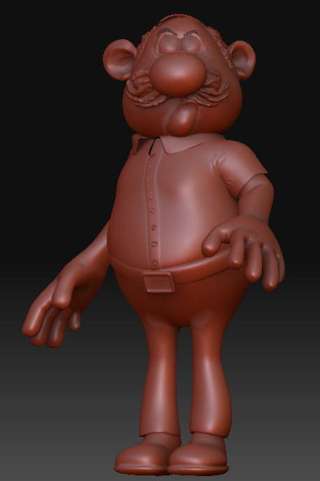

It’s so wonderful as long as I’m working inside Zbrush, but once I try to take the model to render it in another application, the frustration begins!
I’ve been working on a model, and I really tried my best to get it rendered in XSi, but couldn’t
can any body help me with this please?
this is a render of the model in ZBrush 3
[and you can download the ztl file from here](http://www.islamheart.com/haridy.rar)

I did import your model, but with respect, I think you need to clean it up. There seems to be a lot of border edges all over the place. You should try to make it one mesh, or keep it as separate meshes, but give each one individual uv’s. At first it wouldn’t import to XSI cleanly, and I imported to wings and exported again, then it did load.
The alpha depth was 147.88!! I don’t know much about the whys of it, but it seems very large to me, though as I say I don’t know much about the technicalities. XSI only goes up to 100, and my previous alpha depths went up to 15 once, that was tops.

No I did render it, but it came out “bloated”. Didn’t look right at all.
well, I’ll try again any way, I found out something, maybe the issue is that I didn’t convert the displacement map to RGB before using it in xsi.
also I’ll try to bake the high res geometry normals and AO to the low res rather than displacement if it doesn’t work :confused:
