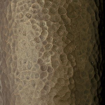

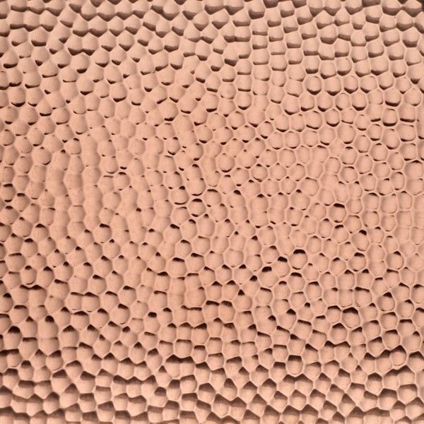

Hi, I’m fairly new to ZBrush and was looking to create a hammered metal effect like the pictures below…
I tried using the Trim Dynamic brush as a spray, but the ‘dimples’ I am getting seem too round, whilst the reference show more irregular shaped ‘dimples’.
If anyone knows how I can get this look then that would be great.
Thanks! :slight_smile:

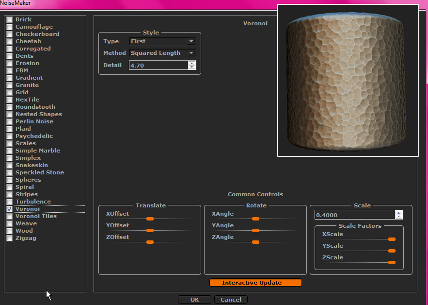

you can probably achieve this with Noisemaker, I used Voronai for this applied as a mask then used Inflate Balloon in the Deformation palette

However, I think spaceboy’s solution is very neat, and although the edges of the ‘cells’ are sharper than I would like, it saves a lot of time and looks good too.
I have a good couple of options now, so thanks!
