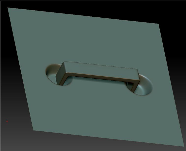

Thanks pabgo, I found my problem, but figured i would post here for other’s who may make the same bone-head move.
Attached is my object i was trying to build VDM from:
I think you can see the issue; it is two objects i simply ‘merged’ together. I’m guessing maybe i could ‘dynamesh’ them to make it work? Instead i just started w/ square and hand sculpted the effect i wanted.
