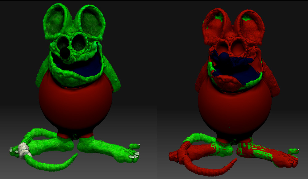

What I mean is I went through the painting process and then selected New from Polypaint and the texture on the model looks like it unwrapped and then was re-wrapped on it the wrong way. It isn’t what my model should look like. Is this normal, or should it stay like the way I painted it?

Below is the image before I click the New from Polypaint button and after.

How are your UVs?
Did you do an UV check first to see if they are ok? (I don’t know if you did your UVs in Zbrush or if it comes from another 3D package.)
ZBrush read the UV coordinate differently from other 3D package.
You have to flip the texture vertically by going Texture --> Flip V
if you`re importing or exporting to different application.
