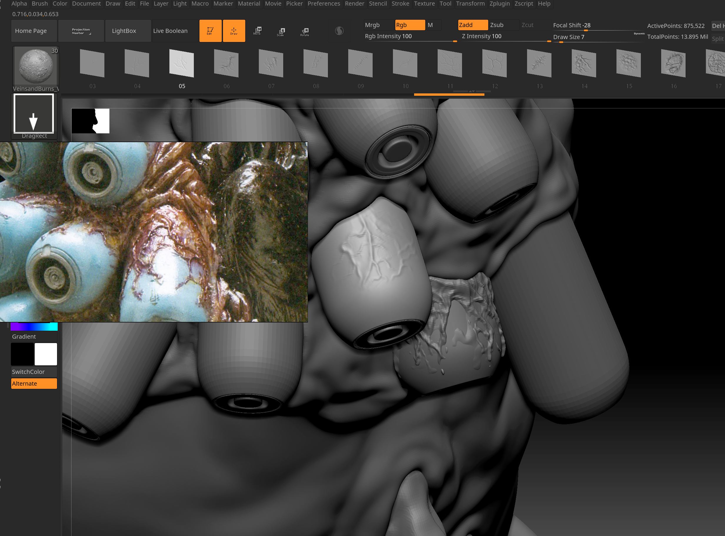

Can anyone recommend how to get detailed Veins and Soft Tissue like the reference image ?
purchased a Veins and Burns Brush from Gumroad but it’s way tooo soft as you can see on one of the Cylinders in the image. The Cylinder next to it i i was sculpting things with regular brushes but still not getting the results i am after. Any help would be sooo appreciated.

I would choose a hybrid approach. Looking at your reference image, you have sort of a veiny “film” that is a solid mass in many places. I would probably start with a Mesh Extract to create the film as a separate subtool that I could sculpt and dissolve a bit in Sculptris Pro mode, use tube strokes to define the major vein detail, fuse everything together, and use textures or alphas to mix in finer detail–not necessarily in that order.
Huge thank you for your insights. All great points to try and experiment with. The biggest intimidation is still those super fine veins and bumpy tissues. Am wondering where to even find a texture for such a thing to spotlight with ? or even how to sculpt such fine detail. As is, I’ve had to bump up the geo to 3million polys on just one of they cylinders to get smooth large veins with the alpha brush i purchased. I’ve duplicated the cylinder 3 times. One level for veins, second for tissues, third as base. Not sure if that’s going to be stable for zbrush when applied to 6 or 8 cylinders ?

sooo grateful for your insight. still feeling overwhelmed and lost on how to best achieve the Tissue and veins on this cylinder area. need guidance on how to best approach this area ? what techniques ?
Where I’ve been stuck for weeks is the Cylinder Tissue and Veins. Can’t seem to figure out how much detail is too much or too little to go from Zbrush to Substance to do the Hi Frequency Details ? Also think my zbrush method of sculpting is this area is looking a bit messy ?
