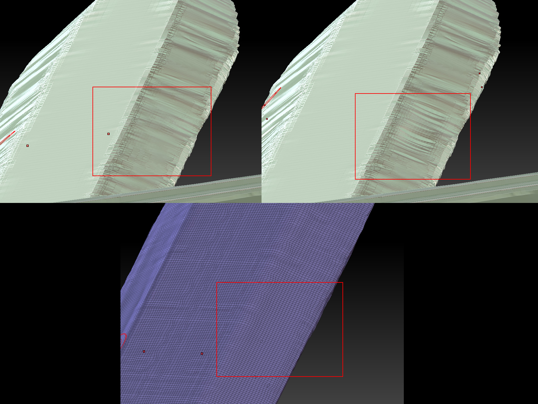

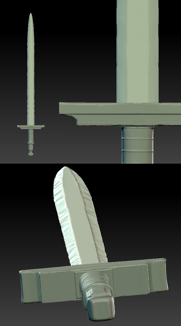

I’m working on a sword and got a decent edge on my blade using Trim Dynamic, looking at it from most angles its good, however, looking down the blade the surface is actually very uneven.
I’m able to get smooth surfaces on planar faces using Planar, but this is a curving face thats off axis.
Any advice to achieve the results im looking for would be greatly appreciated. Thanks!
Image attached.
I forgot about Hpolish, thought that might help smooth the blade edge but it did the opposite, causing elongated artifacts id expect from a mesh with poor topology. The topology looks uniform to me though. Still out of luck.
screen attached.

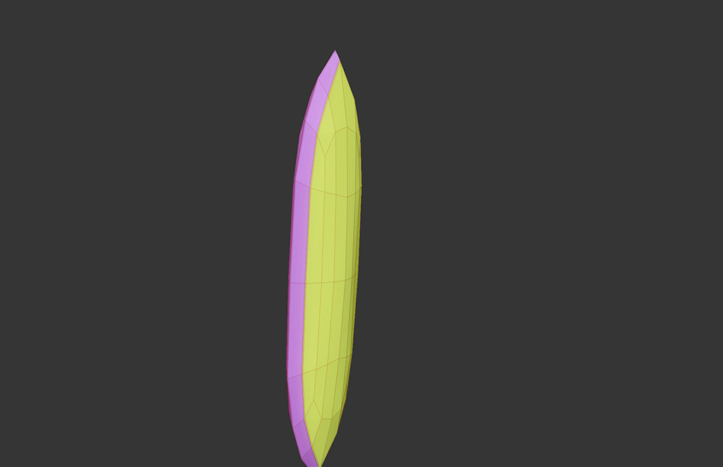

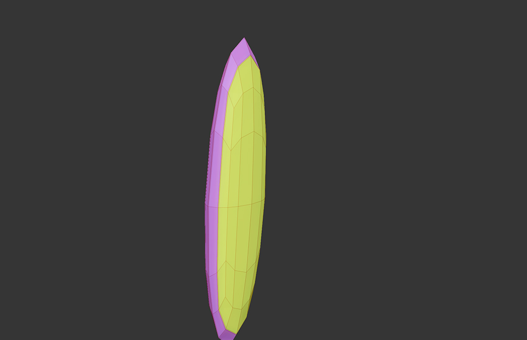

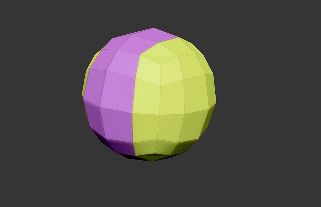

You can do this without zmodeler…
Create a new polymesh3D
Initialize > Qsphere xres 4 yres 4 zres 4
Group and crease as shown
Transform x, y, z as required
With the move topological brush, move the points/topo to the shape you want
flatten z
tweak final shape, etc
