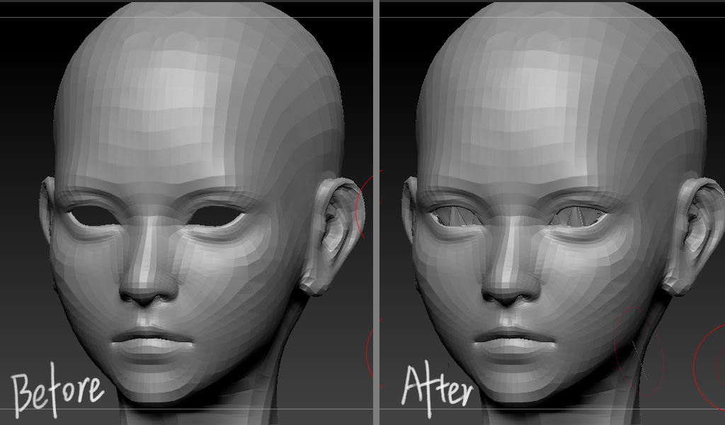

When I use Goz to change the topology of model in maya,there is a wrong vertices location problem appear when the model back to Zbrush.
If you change any topology of model use Goz with Maya,the problem occur on the ‘hole’(just like mouth,eye socket and nostril)of model.
Any ideas is welcome:)

Which kind of topology edits did you do? Most of the time, such problems appears with incorrect topologies (vertices non welded, overlapped vertices, non manifold meshes, etc).
if you do go from ZBrush to Maya then back to ZBrush without changes in the topology, it’s ok I guess, but if you simply do a single polygon extrusion on the forhead, does it works fine or not?

Most likely what you will need to do is adjust your Projection Dist. There is no way to have a default setting that will work with every model. By default the distance is set at 1. I have found with most of my models I need to adjust the dist between 0.02-0.09. Now this is something that you will need to do a trial and error on. There is no sweet number that will work with every model but the above seems to be my range.
All you have to do is adjust the Projection Dist and then GoZ from your other app. If it does not work do one undo, change your dist again, and then GoZ from the other application.

Paul >> On simple extrudes and adding “outwards” to the model (plus Normal direction) on models, adjusting the projection distance works great. Cheers!
