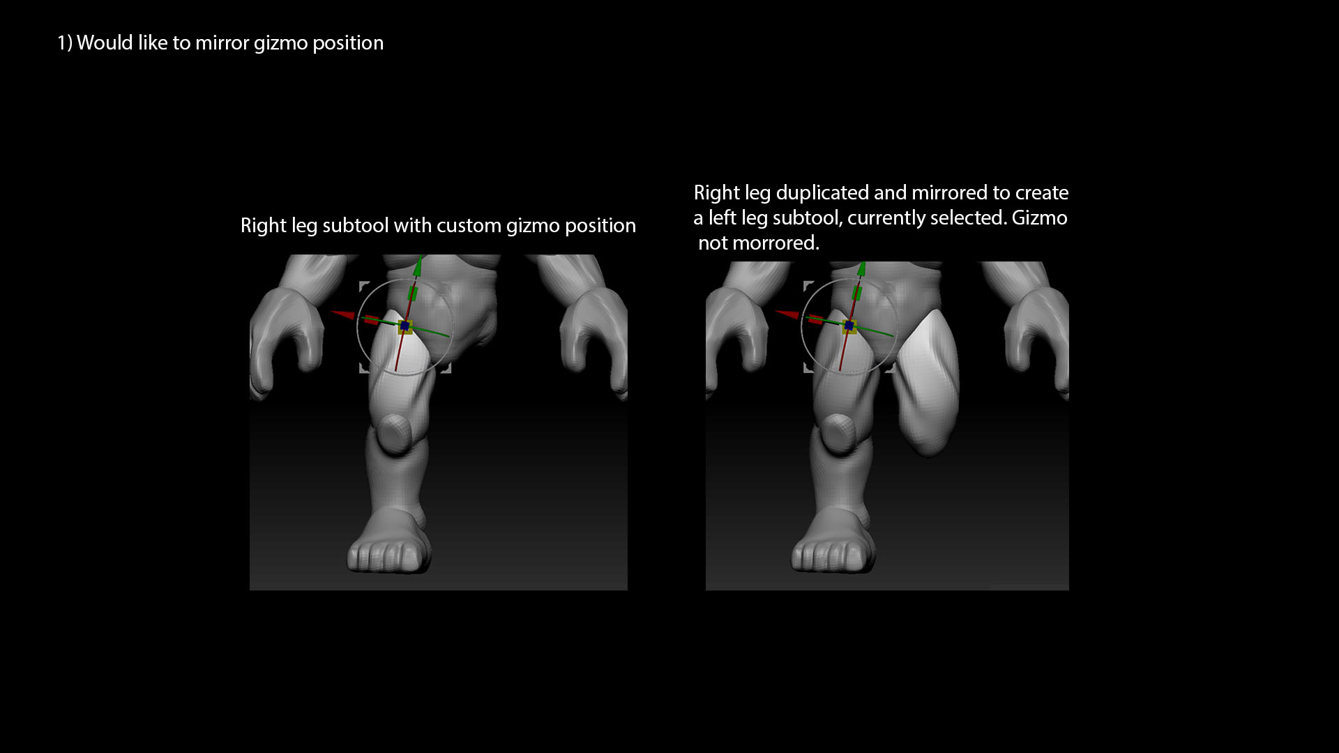

  1. When mirroring a subtool, the gizmo remains in its position. For example, I am building a basemesh which I antcipate reposing many times in the future. I position the gizmo at the hip joint of the upper leg subtool. When I duplicate the subtool and mirror for the other leg, the gizmo remains behind. Is there is a way to mirror the gizmo’s position, so that I don’t have to hand place it each time?

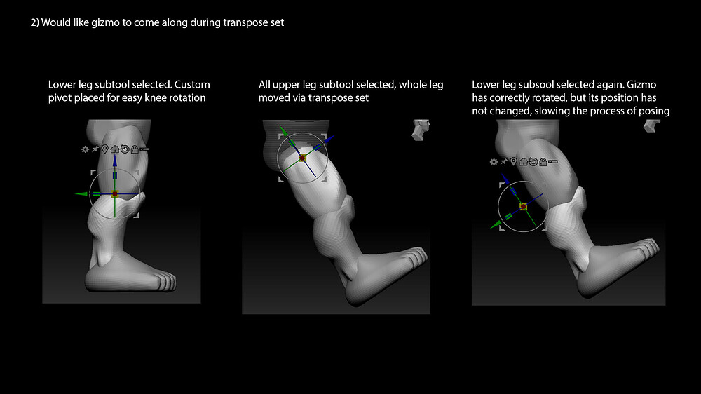

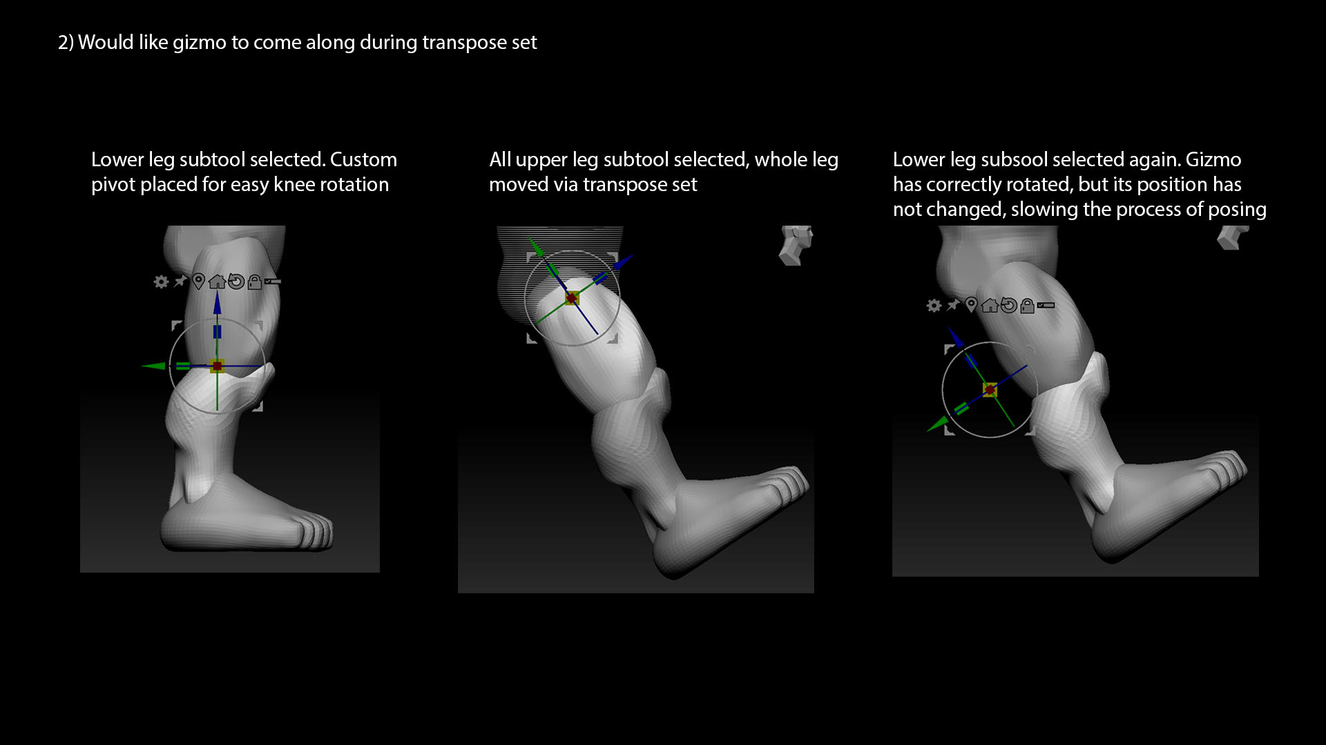

  2. When using transpose set to move a series of subtools, the gizmo is left behind. For example, I would like to rotate the leg at the hip, but when I do, the lower leg gizmo remains in its original position. I would like it to come along so that I can quickly bend the knee, without moving the gizmo again each time. Is there a way to do this?
