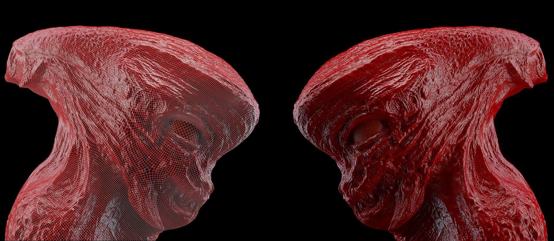

A speed sculpt I created from a dynamesh sphere, first sculpt in a long while which I used to test my Zbrush to Maya workflow. I did a quick retopo on the model using Qremesher and exported some mid level displacment and bump maps to add the details to the model.
The decimated model ran at 20k polys which I feel is still a little high. I’ve been looking at both 3dcoat and topogun for created my final topology ready for animation. Any reccomendations?
Would love some crits on the model, I also included a turntable render at the link below the image.
Rendered in Maya 2014 Using Arnold Renderer.
TURNTABLE RENDER - https://vimeo.com/99831892

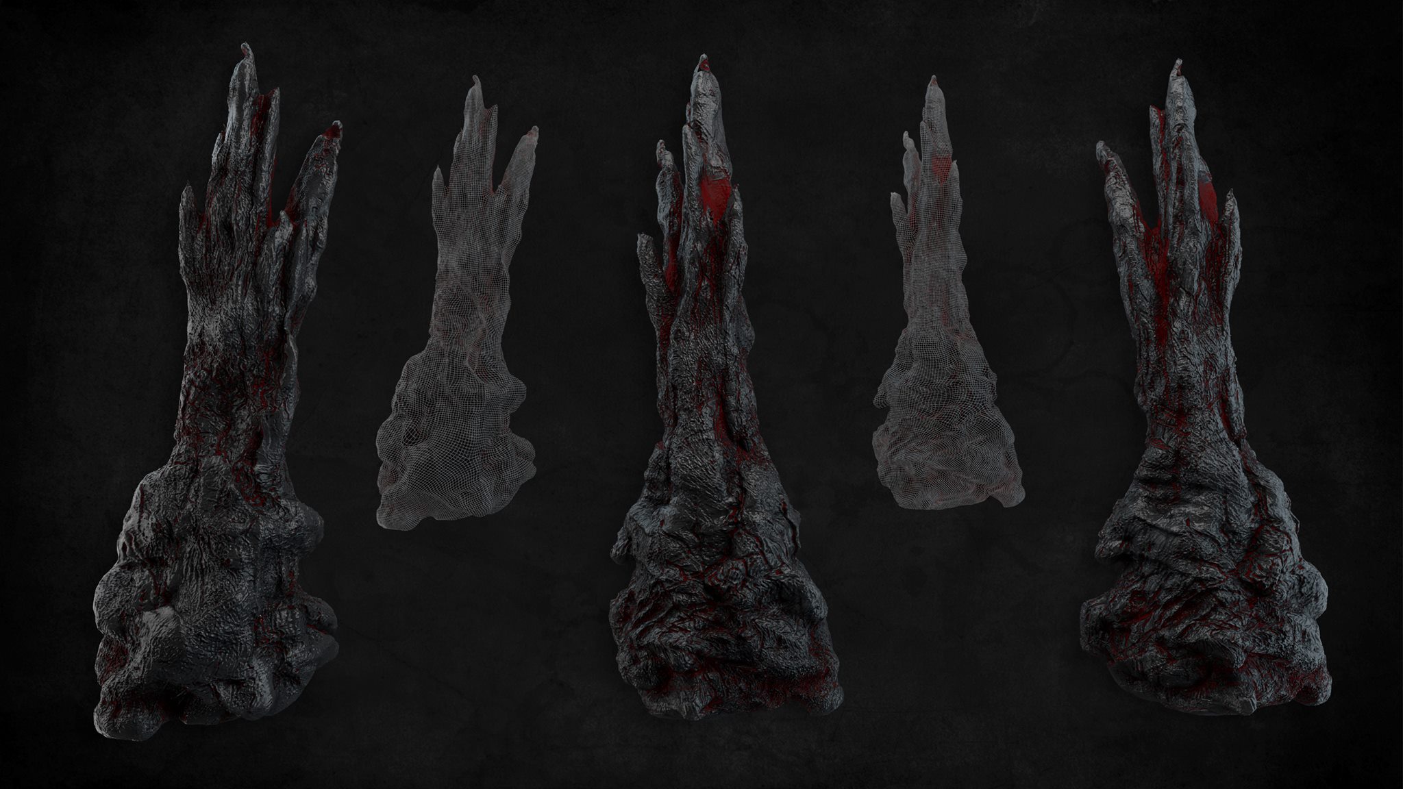

Our short film includes some very rocky terrain so I decided to see what I was able to come up with last night. I started this from a dynamesh sphere but recon I’ll do my layout in maya for the next project as I imagine it will be easier to start that way and add details later.
I exported cavity, ao, displacement for this model and used both cavity and AO to build the diffuse map by colour remapping a ramp to transition from light grey to dark grey and then to red to give this heated lava feel. I also used these maps to create the bump and specular maps for the model. If anyone’s interested in seeing shader networks and texture sheets let me know and I can upload those.
Cool stuff…
If you really used Qremesher, you need to upgrade your Zbrush.
Zremesher in the latest version (4r6) is lightyears beyond Qremesher.
Thanks Thor, I just did some googling into Zremesher and it looks great! Will try to upgrade asap, by the looks of it I’ll be able to do all my retopo in Zbrush with that plugin. Thanks for the comment.
