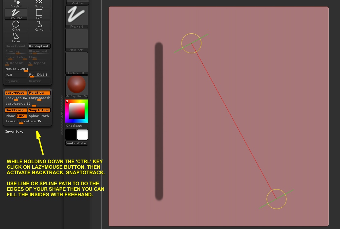

You can add a Lazystroke to your brush with Line, Snap to Line and Back track, then you’re all set for precision line masking. It’s a workaround I use.
Note that you must be pressing Ctrl down while selecting those lazy mouse options so that they apply to your masking stroke.
Here’s a visual representation of what Extra Dimensional is talking about. This is for masks. You can do the same for regular brush strokes, just don’t hold down the ctrl key.
Excellent. Thanks very much!
Great workaround :+1: (And another one for the big book, Nancy! :wink: )

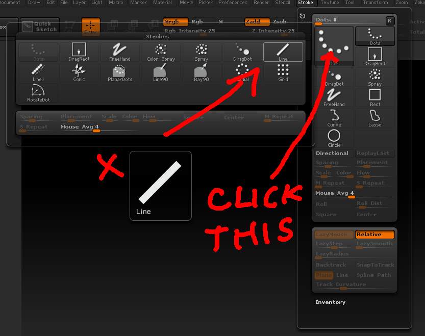

great work around, however snap to track isn’t available in projection master. Anyone found a work around to allow a straight line while using the line tool in PM?
In Projection Master you use the 2.5D tools, for which there is a greater range of strokes. Click the Stroke>large thumbnail to show them.

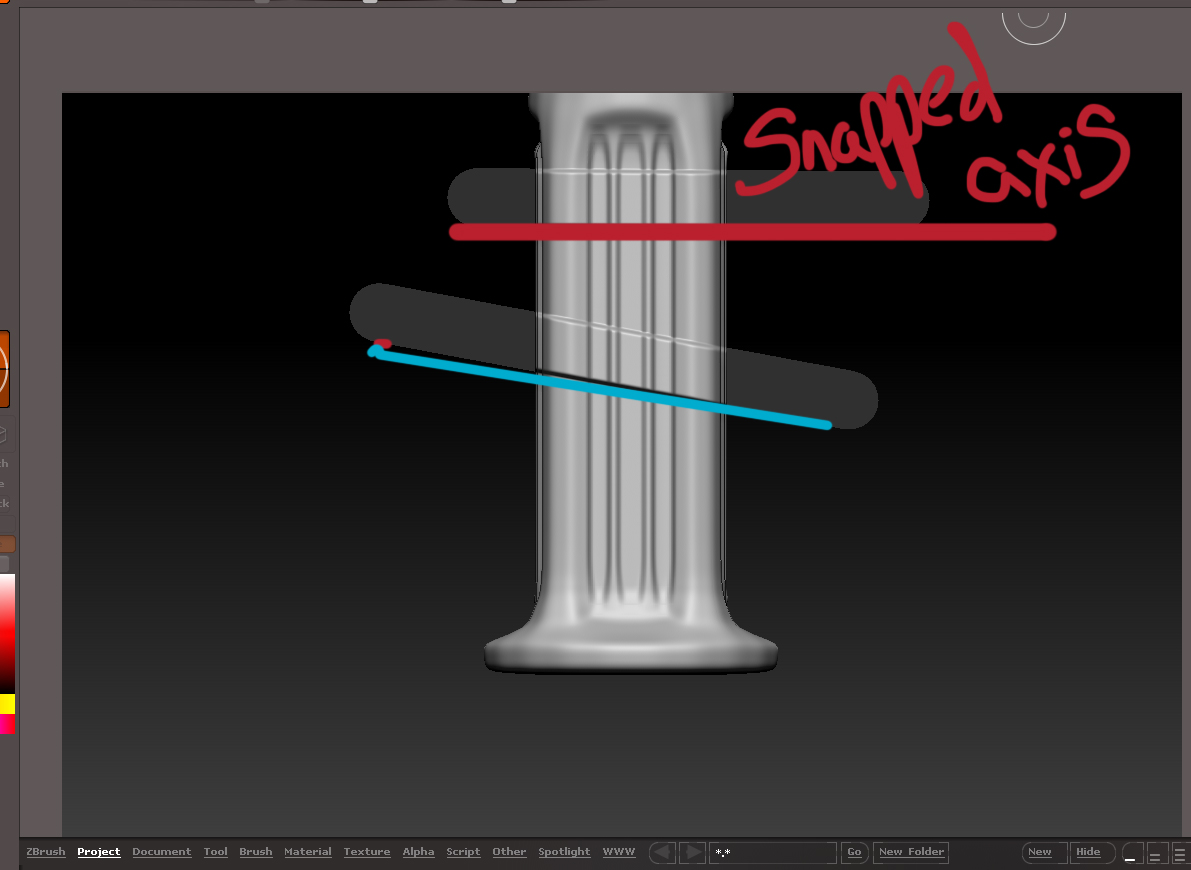

Heya Marcus,
Holding shift doesn’t constrain the line tool (or LineII) to snapped axis as one would expect. Oddly I have noticed that every now and then it will snap, and i think its somehow related to what alpha is selected.
Heres a screen shot. I’m looking to find a way to make a perfectly horizontal or vertical line.
Thanks Marcus
I didn’t have any problems at all in Projection master. I tried Line stroke and LineII stroke and different alphas and it snapped to horizontal and vertical with no problems. You just have to make sure you start drawing your stroke before you press Shift.
Thanks Zber,
I think i was pressing the shift before my stroke was actually over the mesh but after I had actually started the stroke.

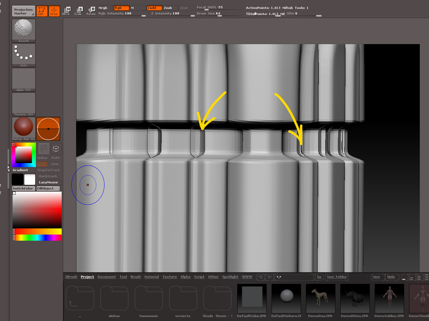

Any idea about the zsub with PM leaving those faces/edges in certain areas?
I don’t think it matters if the stroke is on or off the mesh as long as you start the stroke first then constrain it to horizontal, vertical or 45*.
As to the other part, this is normal for Projection Master and nothing is broken. I think it’s because of the fact that it builds on or subtracts from existing geometry and that it does this in 2.5D.
