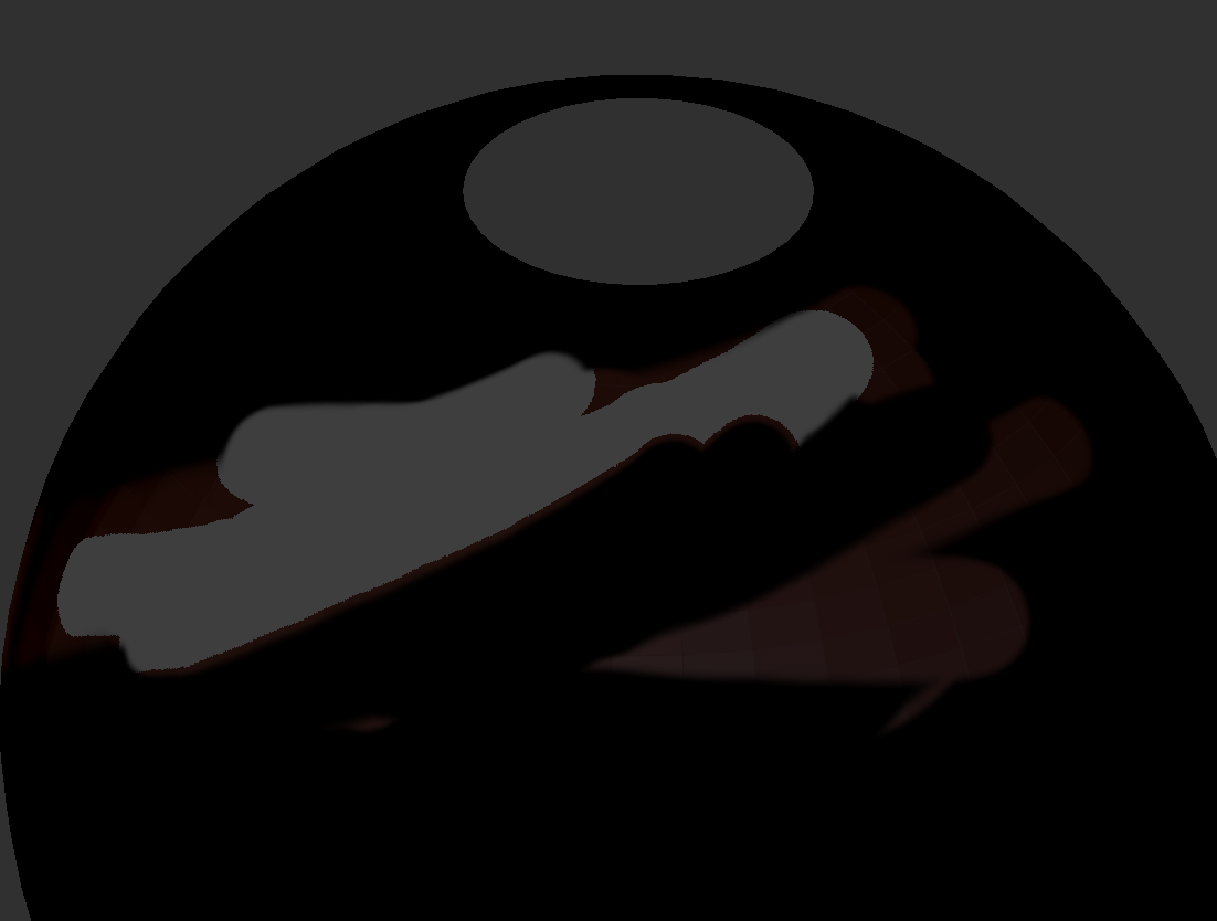

Hello, I am trying to paint a rough background on a dome in ZBrush and so naturally I try to use the flat color material, but I have to say right now that flat color has been glitchy to the point of uselessness.
It’s supposed to be a night background so I start with full black and then I try to paint another color and it’s like it’s trying to get back to using the clay material. I know other people have this issue so what’s the solution?

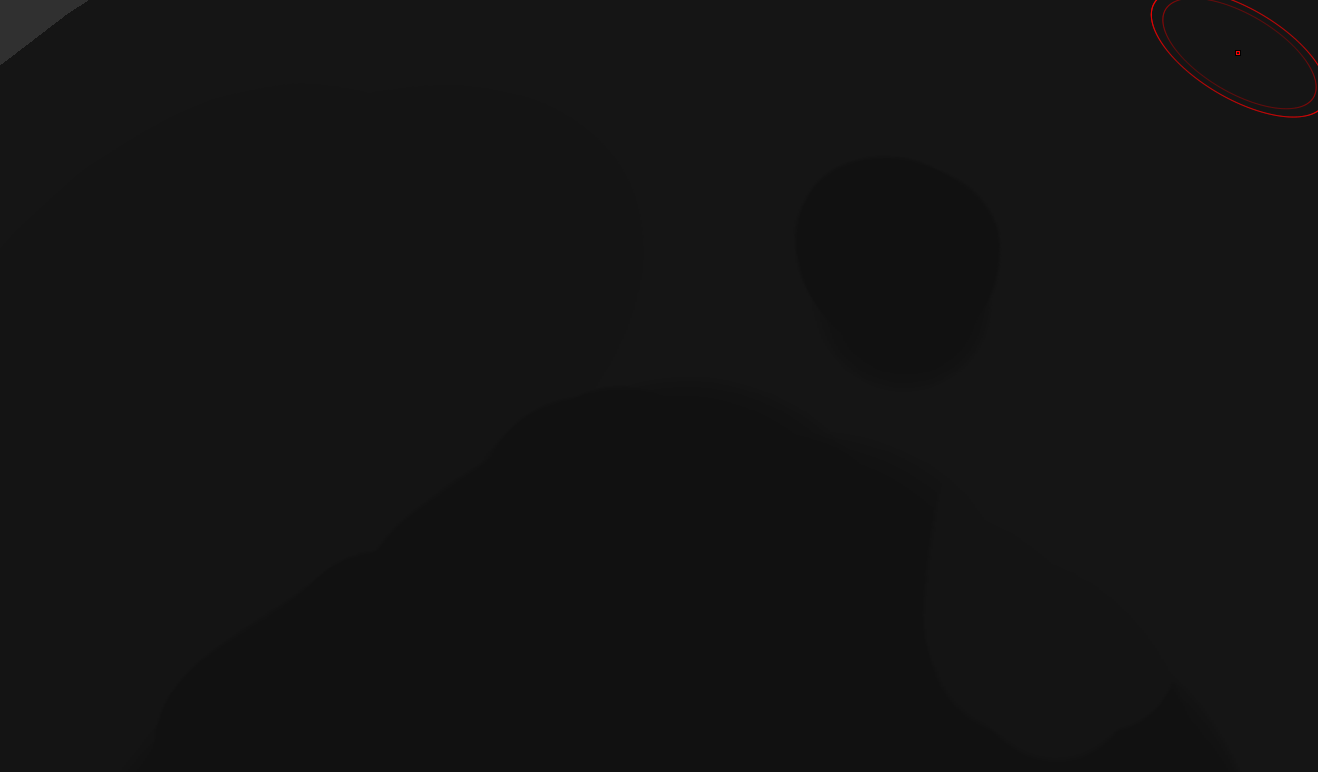

That’s interesting but I don’t think that’s the problem here. Another issue that I am getting is this weird “layering” issue where I can’t completely color over something, like it was masked (yes, I checked to make sure there was no mask).
As you can see in the image, I have three different blacks (none of them are pure black).
Long story short, I paint the darker black over the ligher black but when I use the lighter black to try to paint over the darker black, it becomes that middle shade of black no matter how many times I try to paint over it. It’s like a mask. It’s feeling rather nonsensical at this point.
