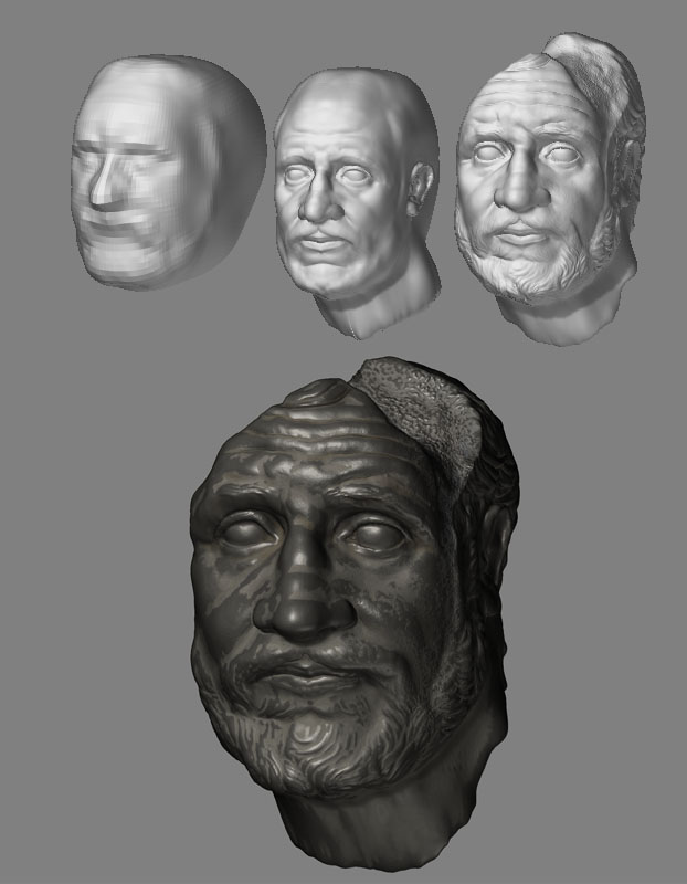

Here are some of the shot that comes straight from zbrush. I also did different meterials that i like instead of following the picture’s texture.

I haven’t said so earlier, but this level of detail coming from “the ball” is simply amazing. We are talking a Sphere3D rather than ZSpheres, right?
Thanks Ctl_Z, yes, it was created from 3D polymesh ball. Here are the progress shots.head_progress.jpg
