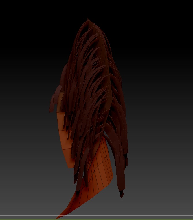

Do you have any idea why when I’m creating these hairs that they are doubled? If I turn the hairs to the backside they have been duplicated, mirrored actually. Thats crazy! :confused:
Which Fibermesh preset are you using?
BTW are you sure it isn’t just display-doubled (double clicked in display properties)? It’s just that I’m not fully understanding the problem from the image you posted. Is it that the fibers are showing on the normals side and also underneath on the flip side?
Seems that when I have a solid mesh, like Dusk’s head as it’s guide, the double thing goes away but if I have a piece of unclosed geometry the double sided effect shows up. I do have “Double” turned on but when I turn it off the double sided thing is still present. :confused:
What Fibers preset are you using? Also is the back part different groups? If it is, you might be able to delete groups you don’t want.
Seem you were right. If you turn on Double then the stupid fiber mesh makes a double to the other side. They need to do an update to that tool to do an auto update. After I messed around with the controls some more I found that the double was gone. Kinda like the gravity settings, they just sit there static until you release the slider… Be nice to have all this happen in real time or auto update.
