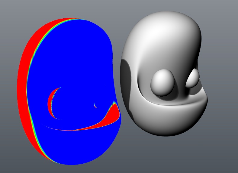

In a minimal option that would require a draft angle analysis to be displayed thus the artist would see whether a given part would eject from the mould, would allow to identify undercuts in the model.
Direction of the draft could be given either by specifying a plane or by drawing a line that would indicate direction of the draft.
Here’s a sample draft analysis I did in Rhino:
Of course it would need to displayed better , so the edit could be done while displaying draft. In fact only undercut areas could be marked.

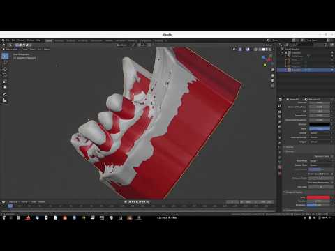

I am searching for an special new ZBrush function called the “automatic conic maker” which does show and heal all undercuts in an alpha made bas relief.
With an option to get the conicity of the bas relief adapted by angel.
Just to make work easier for professional Mold Makers especially Permanent Mold Making.
Easy one click undercut healing… Zbrush could be so helpful…
would be wonderful.
PS.:
In other software types some Phyton skripts made by non professional already try to work in this direction… for example in the following youtube video:
