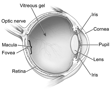

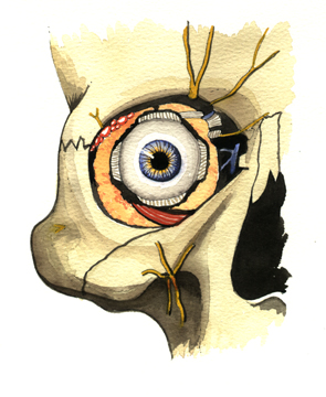

hope this helps.
with eyelids the head is 5 eyes wide, also although the eye might look too small it probably is accurate, we have a tendency to see faces as simple geometric shapes and some distortion occurs in our perception.
also the shape of the eye is somewhat squashed front to back, nd don’t forget the bulge due to the cornea

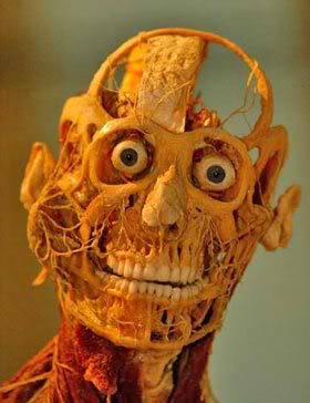

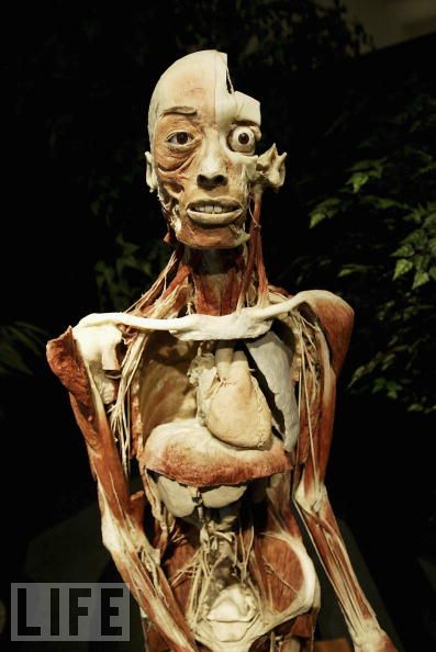

real bodies, real eye proportions
thanks dude
Wow, it’s incredible how small the eye looks in the otherwise empty socket.
Yeah, see, the reason I was kind of confused is I had a teacher who told us that the eye is pretty large inside the skull. He was wrong. lol.
