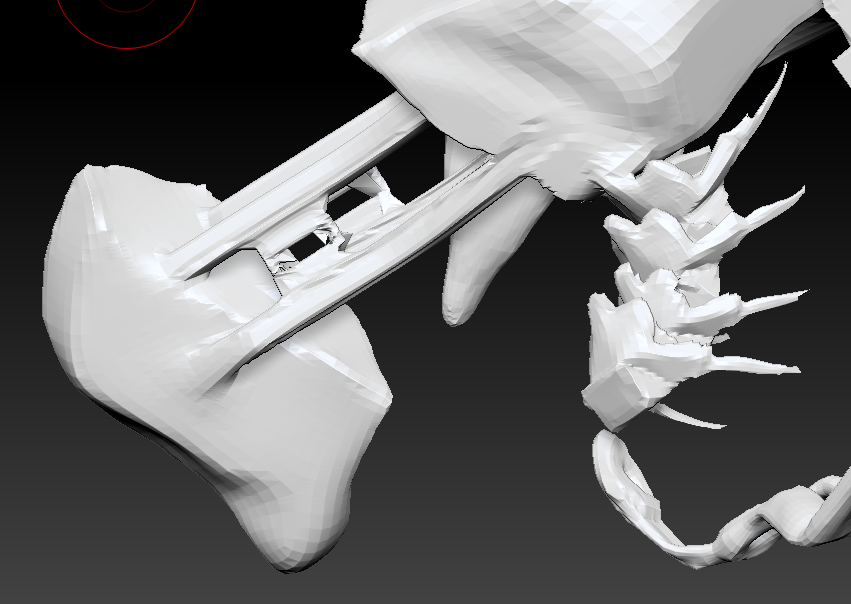

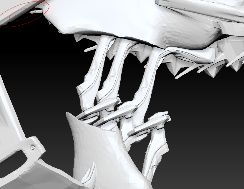

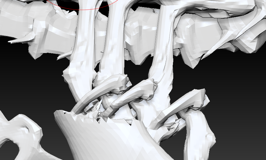

Here are some close ups of the details I’m trying to preserve.
And here is what is happening to them on a 2.6mil poly surface that I’m projecting the details onto…
There is a noticeable loss of fidelity, as well as some (annoying) artifacting. Experimenting with the distance setting on ‘Project’ tool I turn it high for more detail but also more artifacting.
