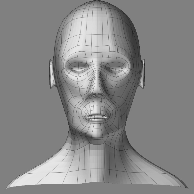

experiment, sphere+edge loop head sculpting

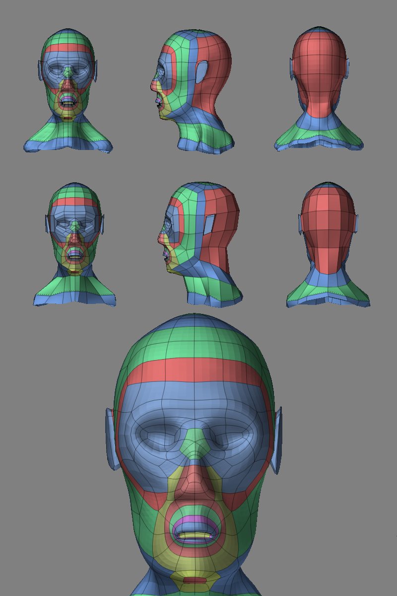

Well, I’ve practiced a few of these for kicks. No doubt that I have too many loops going on, but it’s a learning experience. Any 1to1 you can provide will be appreciated.
One really weird thing. If you edge loop over the poles of the sphere it will actually create a hole in the mesh. That’s how the hole in the top of his head was created and how the neck got started.
Oh, and the thing got a little unsymmetrical. How do I get that back?
Subd level 1 and 3 are pictured here.

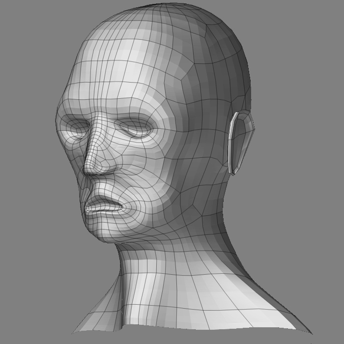

Well, I pulled it into silo to fix the mesh up. I got rid of the odd geometry that I created with zbrush edge loops. I also experimented with going all quads, and I manged to do that except for the few triangles that I left in the nostril.
The edge loops made it a bit easier to move things around naturally. Next up, make it look more like a a real person i.e. proportions.
reworked a bit of geometry in silo and then ajusted the major proportions of the head. This is sub-d level 2

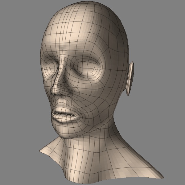

Hey, a little help from sokar, and some work on the face and he’s starting to look like a person.
Sure he’s an eyeless freak with a broken nose and a swollen lip, but still, he’s starting to look like a person. :smiley:

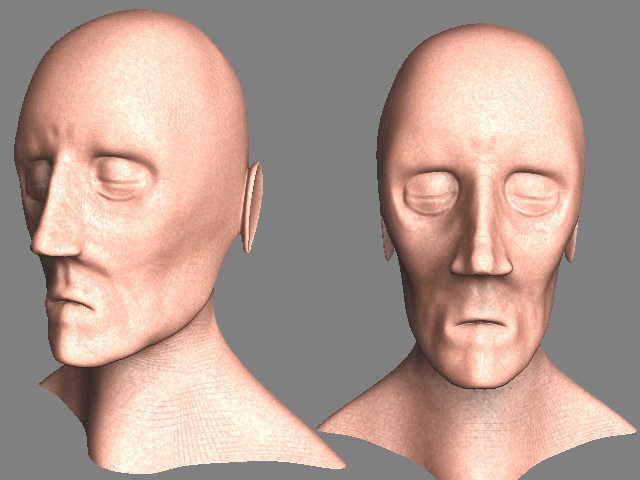

![another-damn-head.jpg|640x640](upload://44Yqe983Xkg1CBXztAXg5nYbQyE.jpeg)
Still working on him. I think it looks more like a person now. A skinny freakish sort of person, but a person nonetheless.
C&C appreciated
