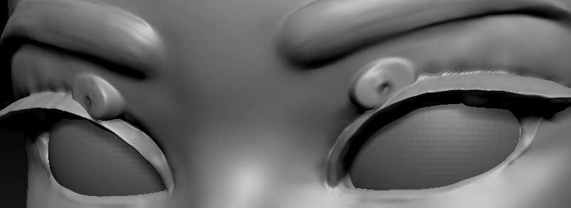

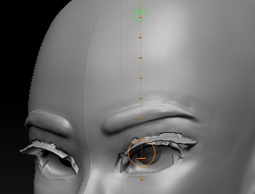

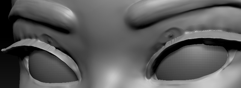

Hi everyone, new to this forum but desperate for an answer…I’m a total noobie and just getting into ZBrush, was working on this very basic head when I found a strange problem within the eyelids. I wanted to give it stylized eyelashes but don’t have Maya so I tried to sculpt it in Zbrush. I can’t seem to shape, delete, or move a very small section in any way. When I try, I either seem to unearth a conical shape, or create a neverending hole. Then I realized this is also the case with the underside of the thickest part of the eyelashes. I’ve turned the temp eyeballs on and off, they seem normal. If, however, I do try to scale the head itself, it seems to amplify the weird shapes that are causing these problems. I’ve attached some images below to try and demonstrate what I mean. I’m using the Zbrush Core free trial and am only using the tools and brushes provided. Any advice is welcome!
The odds are that you have a mask applied. You might not see it if you have ViewMask disabled. Go to Tool > Masking and Clear the mask and you should be OK.

Thank you so much that fixed it! And noted I’ll move my questions there for now.
