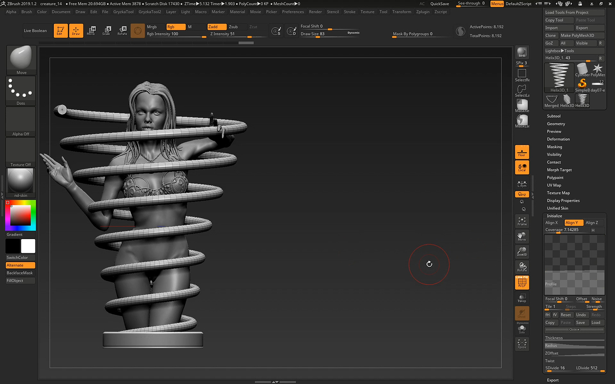

I’d like also add some screenshots with commentary.
Main base was initialized from helix base.
Thickness was done using Inflate brush.

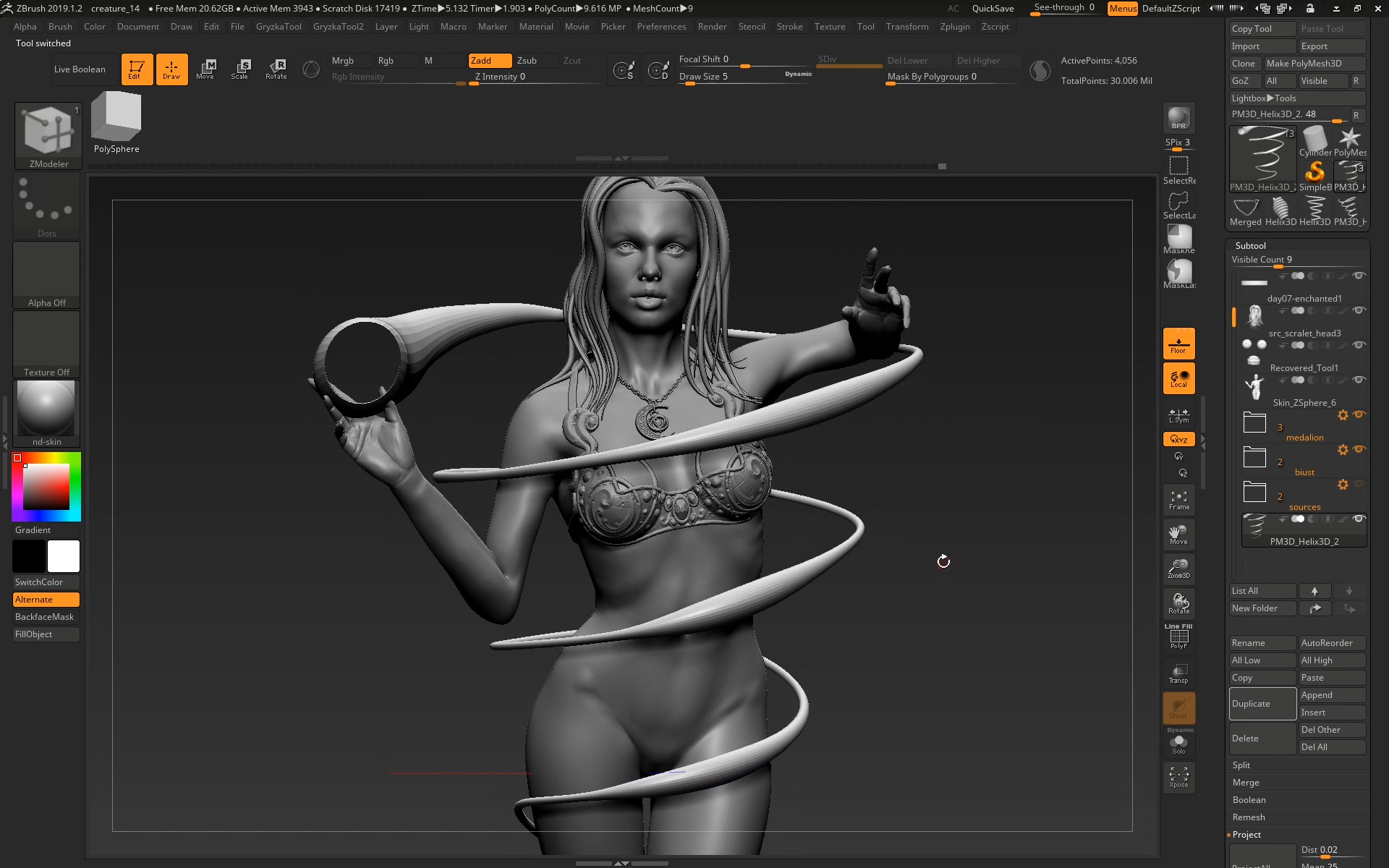

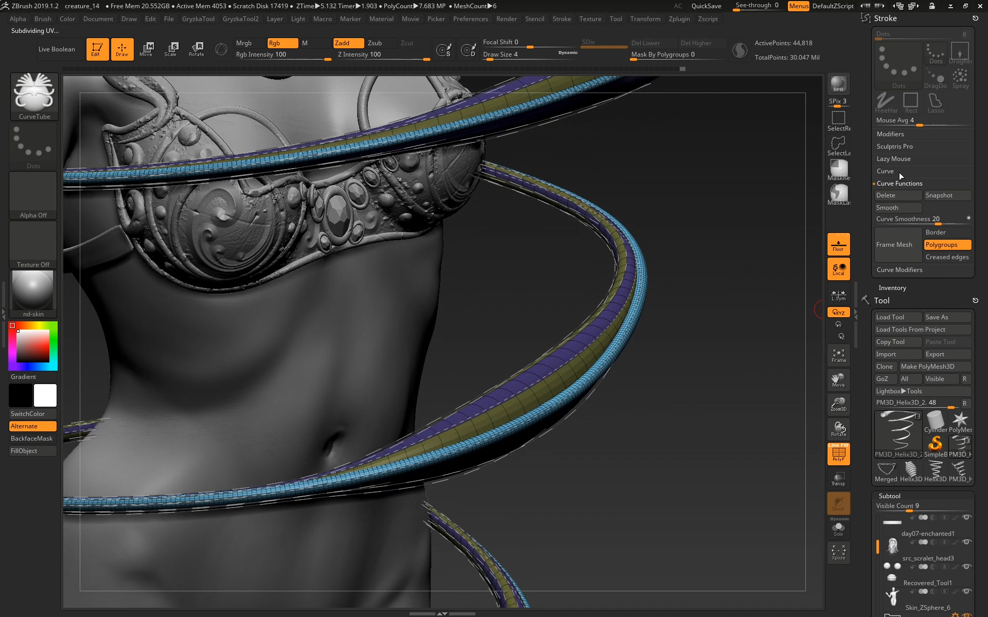

Next, I decided to add some small extrusions using Curve Brush

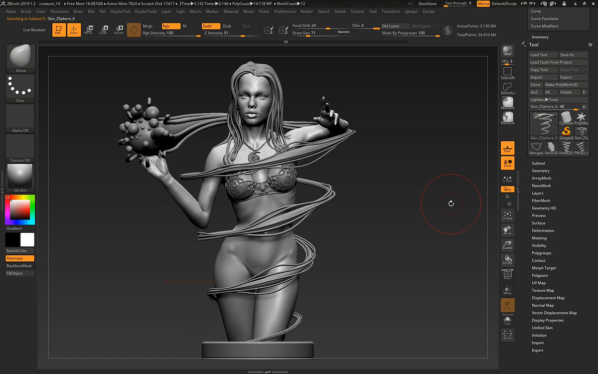

The big drops of particles I did using IMM Primitives brush and I moved trails a little to have it more soft like fluid.

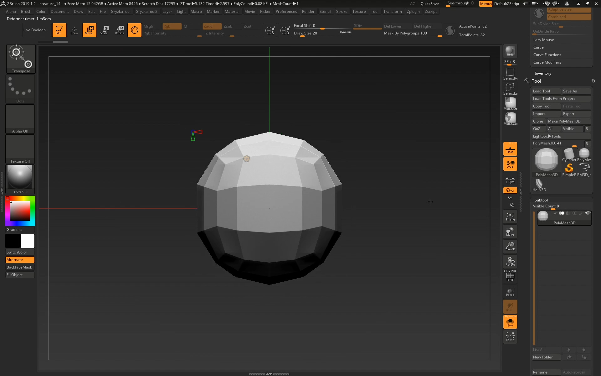

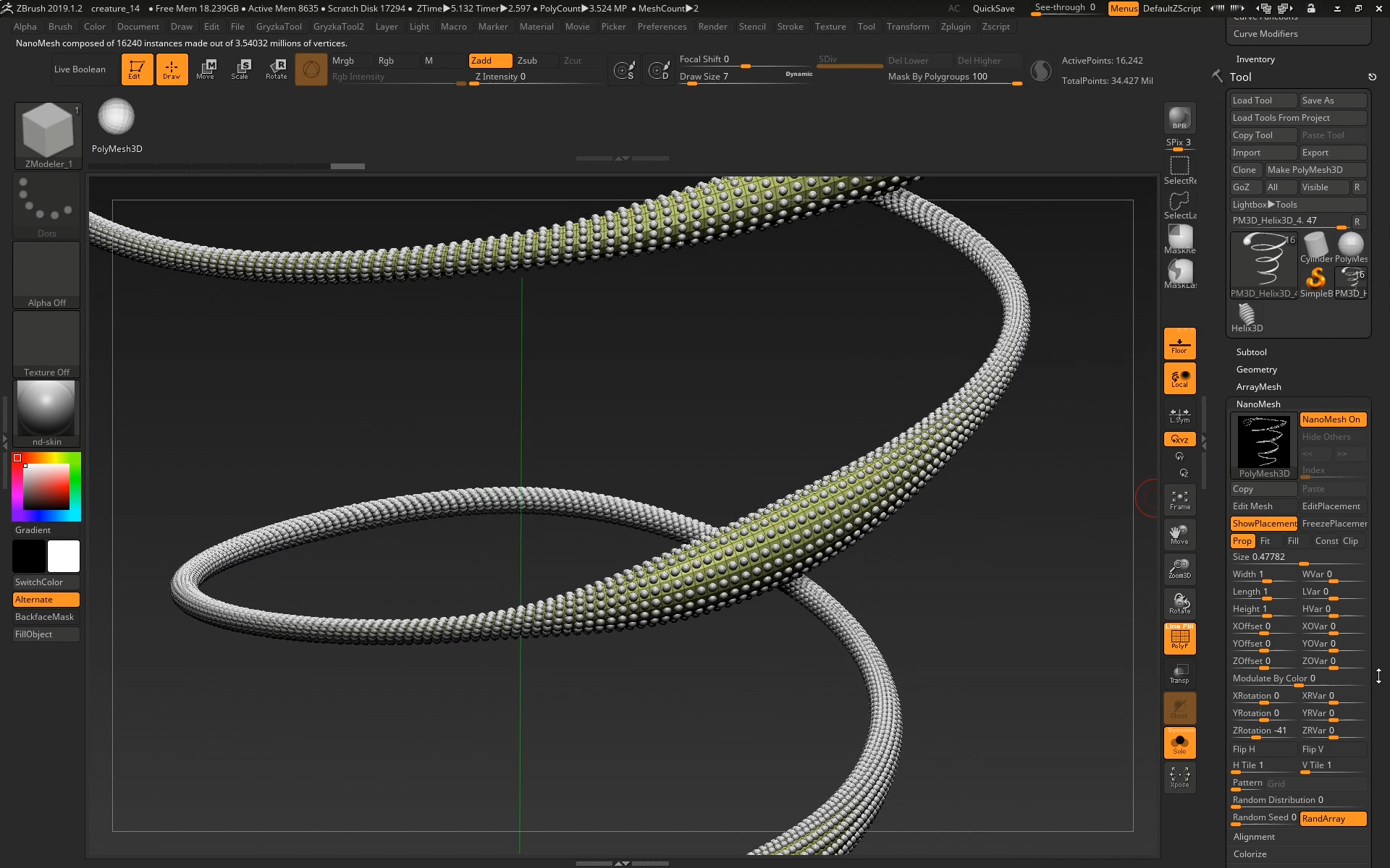

The small drop of fluid was created from Gizmo and PolySphere on very light dense and after that I created InsertMesh and converted to NanoMesh. Mesh

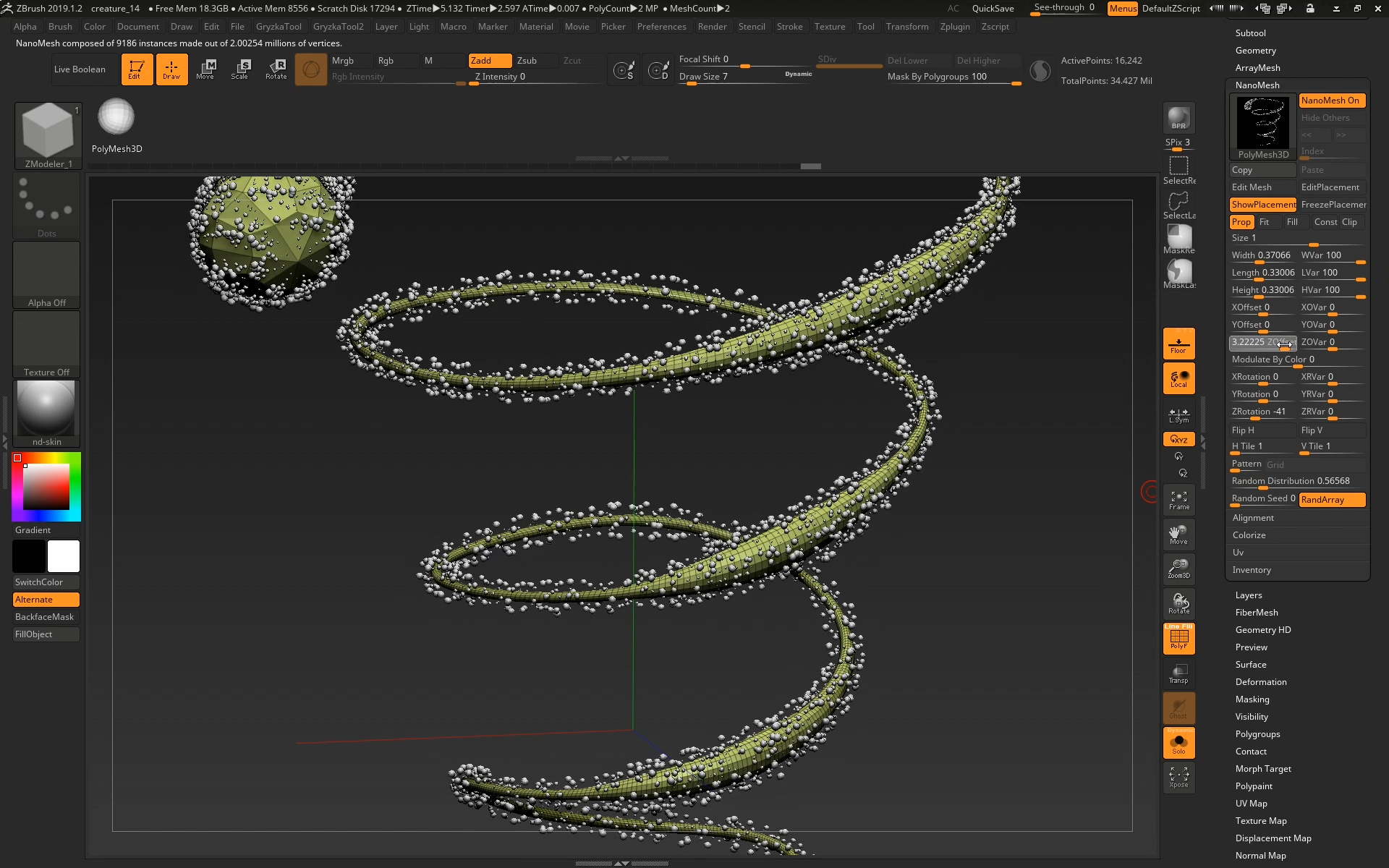

I used simple created NanoMesh on main helix base. As you can see drops looks very regular at this stage.
On the right panel of NanoMesh you can see some of my settings to have drops placed more randomly.
