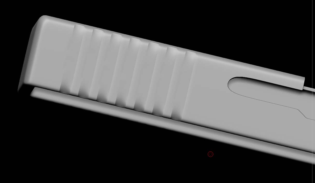

I Start with my base tool, have my secondary tools for subtraction loaded up, Dynamesh the base using Dynamesh Master (which incidentally is like hard locked at some 2.7 million polygons for some reason, even though I set it to 10, and if anyone knows why that would be super super helpful also). Then I take the second tool and make sure its set to subtractive mode, Then I merge down the main tool and the subtractive tool, and dynamesh and everything works great. However, when I load up a second tool and try to do the same thing, everything breaks. It cuts in the new detail just fine, but the old detail that I had just finished making gets extremely messy as if its trying to like bridge a bunch of holes or something. Here are some pictures:
First subtraction works, fine…:

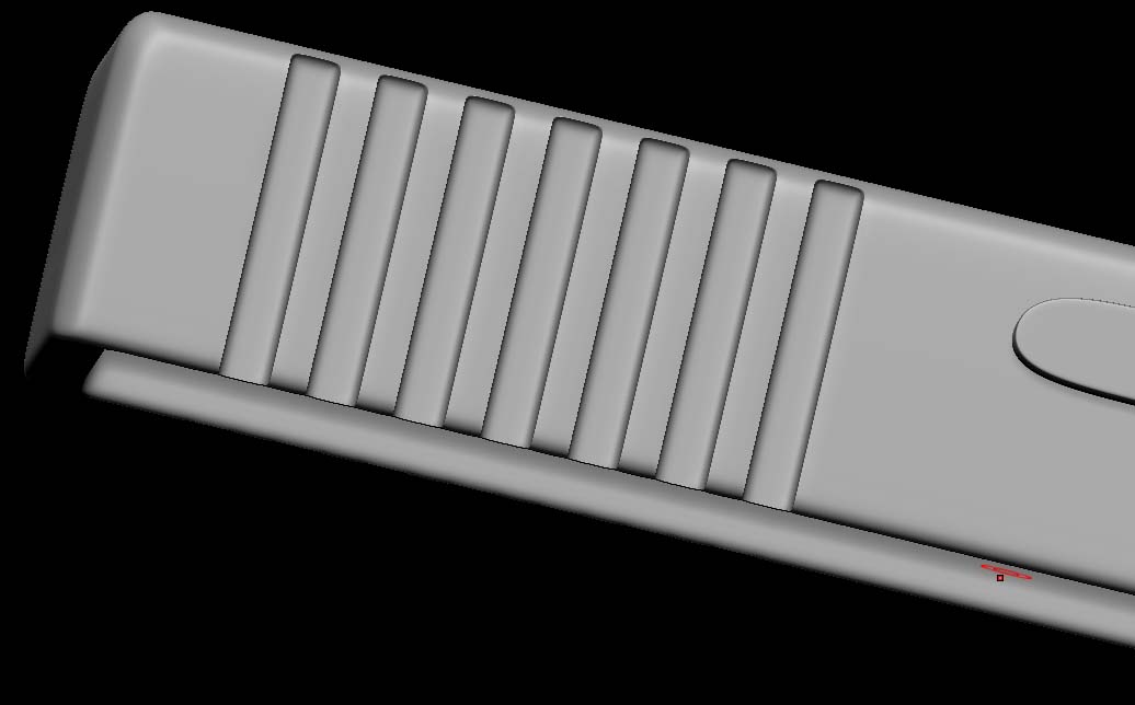

Second subtraction works fine but breaks the first subtraction:
You can see how it has like tried to like bridge the section that I just worked on, the same thing happens if I try the other tool first, it will just make this weird attempt to close the hole… even though I don’t think there are technically any holes in the mesh…

Sorry for the bump, but after further exploration, it doesn’t happen when the Base Mesh that I am subtracting FROM is all the same polygroup. Now this is an acceptable fix, but I did really like having all those inside polygroups that I could use to work with using the polish, crease features etc. When a dynamesh has polygroups is it supposed to behave differently from when its all just one single polygroup?
Thanks
I’ve been trying to the pica tinny rail tutorial in the Z-Brush classroom and the same thing that’s happening to you keeps happening to me and it’s driving me bonkers because I’ve followed the exact steps multiple times! :mad: I can only assume that this is a 4R6 bug because the tut was done in 4R4.
