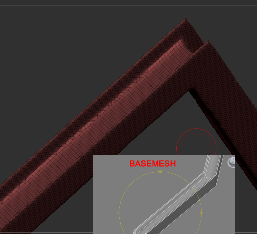

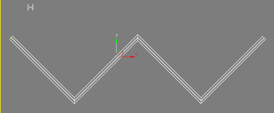

I’ve made this metal bar using the sweep modifer in MAX (on a grid).
But when I dynamesh it I’m not getting enough detail.
Also tried subdividing it a few times without the smooth.
Even then when I dynamesh resolution is set to 1024 with blur set to 0 and projection on.
I get a very low res mesh.
Is this because the base mesh from the low poly needs mores edges/subdivions?
How would you solve this? Or would I need retop the base mesh?

I’ve tried what said, but unfortunate it still didn’t dynamesh high enough. Could it be my shape?
It just a simple zig zag line lofted with (H shape). I made a simple box shape similar to the H shape in max and
it dynameshed too 2k.

But It seems that the mesh is much to long that’s why it doesn’t dynamesh right. I detached one piece in max
and re-imported and dynameshed it… and it work perfect. I’m getting much higher resolution. So its a scale thing too.
So i’m gonna reconstructed it differently.
You’re right about mesh shape.Dynamesh is using cube for projection.So in case of very long objects as your, there will be not enough cross resolution.
Using unify or rescaling in max won’t work to good with Your mesh;)
