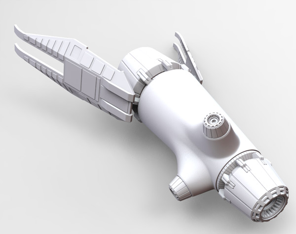

This is true of any program to the extent that hard surface stuff is just more complicated, requiring a much more deliberate way of working, and often more deliberate topology. Organic stuff is more forgiving. I personally work exclusively in Zbrush for HS, and ZB is quite good at it. As with many things in Zbrush though, sometimes it requires a slightly different philosophy. This is what I’m working on in another window:

Thanks for the rendering, that is a beautiful piece of SciFi tech ! I agree, ZB is very good for HS modeling. I am using it more than Maya now even for Low Poly stuff.
I should have been more specific about ZB’s HS weakness - I mostly had Z Remesher in mind, one of my favorite tools , which seems to have problems especially with rectangular shapes, and the fact that Z Modeler lets you build meshes that are “unclean” but pass the check mesh integrity test without being really optimal. I will open a new topic with an example.
