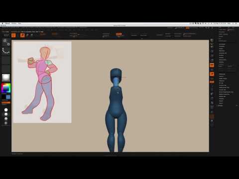

I was watching a tutorial where a character was being sculpted in dynamesh on a low resolution of 84 but he was still able to put detailed crease’s into his character without it looking blocky or low res.
When I tried to do the same thing it did look low res. Unfortunately I’m unable to contact the person to ask.

Not sure if any sculptris option was used as the tutorial is about 5 year’s old. Here’s a YouTube link to the tutorial it’s about 5 mins long but if you skip to 1:50 it will show you the dynamesh resolution settings & at 4:05 it will show the results of his low resolution sculpt.
His character isnt very sharp but the crease’s in his character are alot sharper than I’m getting with the same settings.
Ok, that user does a pretty good job of explaining their process. They actually aren’t using Dynamesh all that much. They are using IM brushes to add additional volumes as separate polygroups so that the individual meshes stay separate when the Dynamesh “Groups” option is active. This allows for some sharper divisions between forms since they are separate meshes that are merely intersecting, and not yet fused together.

Appreciate that :slight_smile: I thought I was using a IM brush aswell but I probably selected something similar. Will give it a try later. Thanks
