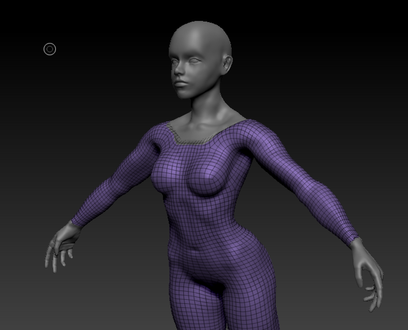

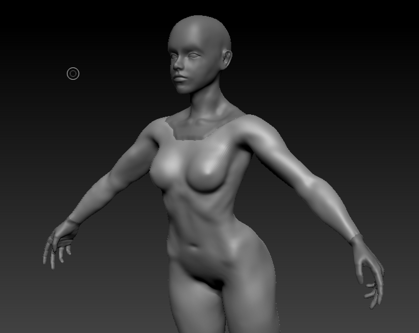

I am new to Zbrush and I have run into an issue with combining multiple subtools into a single mesh.

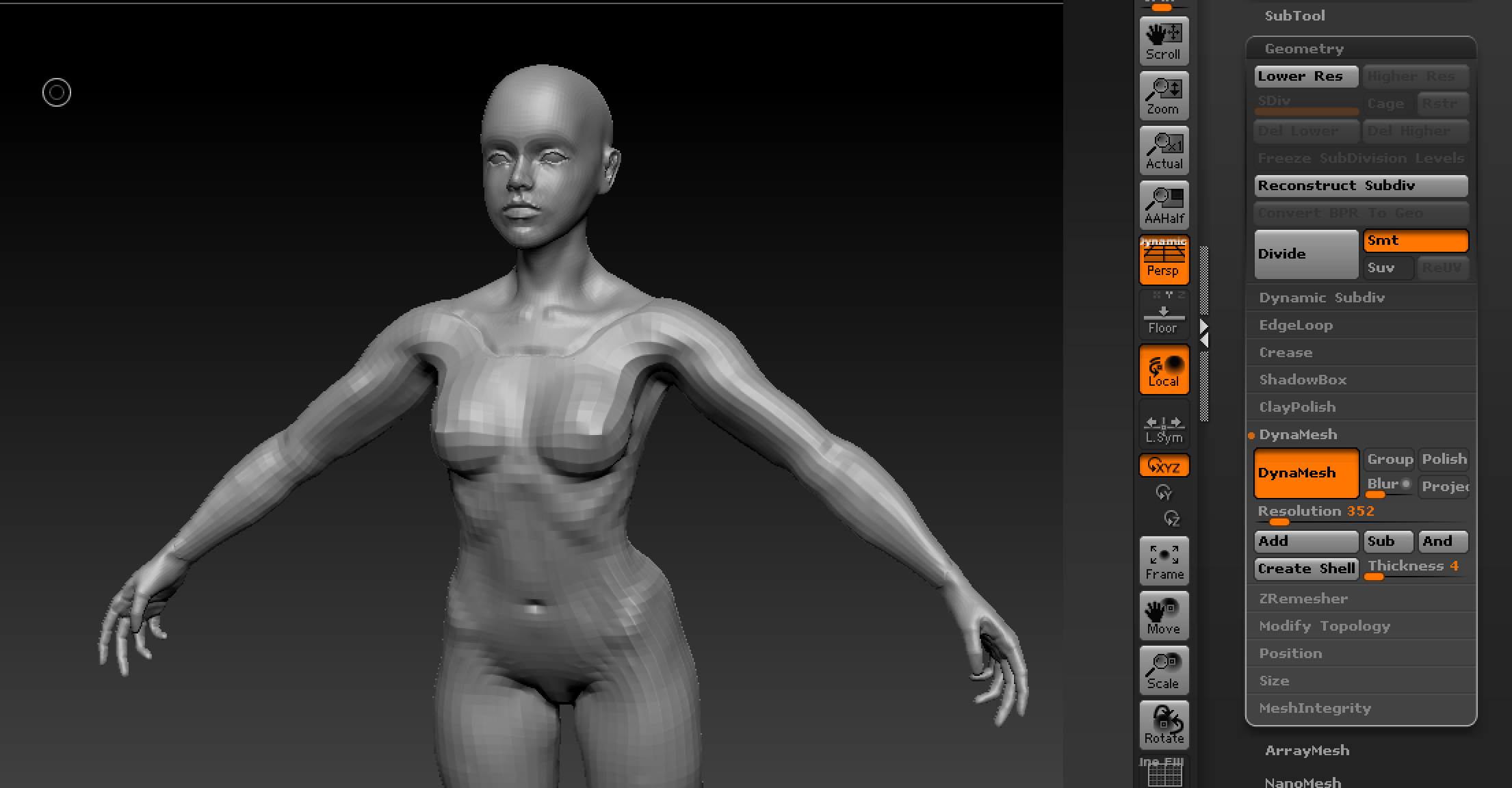

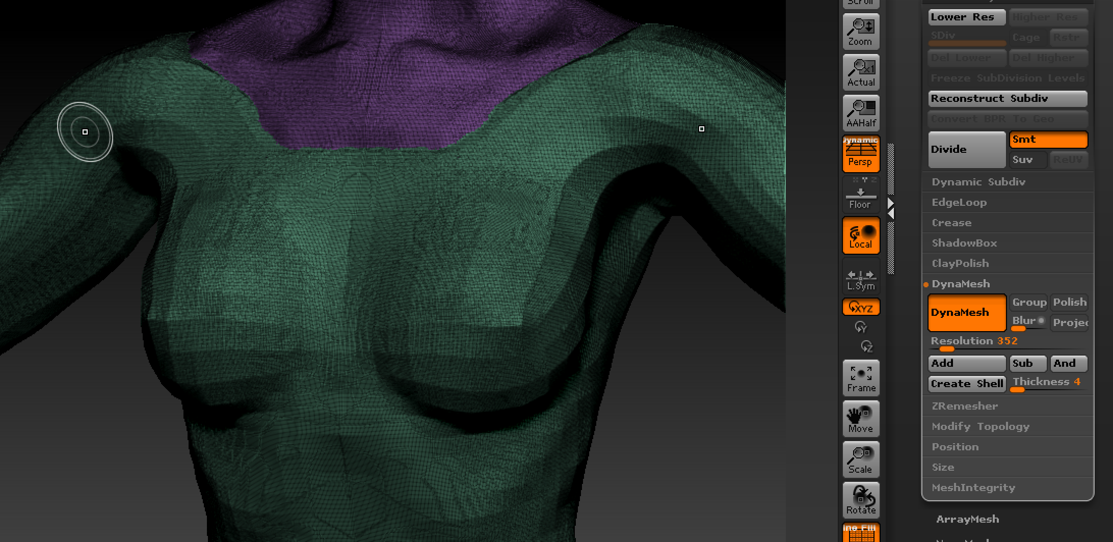

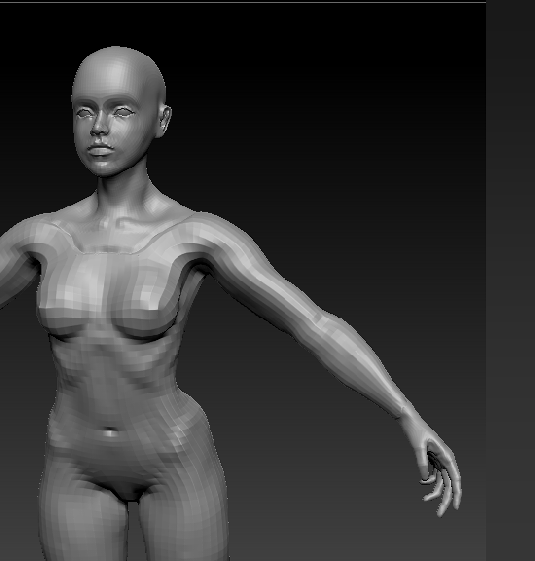

After watching a few tutorials, the best way seems to be to merge down the subtools and then dynamesh them to create a single mesh. However, when I use dynamesh, the mesh looks very low res even though it have over 3 million polygons (I have made sure that the scale is large enough).
The second two photos are after merging and and using dynamesh. I have also tried lots of different combinations of dynamesh settings.
Help would be greatly appreciated.
It looks like you need to delete your subD levels before merging your two meshes together.
You’ll want to make sure you dupe your meshes first, then instead you should dynamesh at a lower resolution (enough to keep the fingers and toes separate if possible) then use Zremesher to generate a nice quad topology. SubD up that mesh and use Project All.
Did the original body even have subdivision levels on it, or just Dynamic Subdivision? You’ll want to actually subdivide it a few times so that it is nice and smooth (or apply the dynamic subdivision if that’s what you’re using), and then delete the lower subdivision levels so that Dynamesh will just see a nice smooth surface to preserve. Nothing more and nothing less. Otherwise, if you Dynamesh a low-resolution model then Dynamesh will just see a bunch of larger, low-poly planes for the surface and so that is what it will try to preserve (which is why the result looks lowpoly even if it has millions of points on each plane).
Thanks for the help. I thought the idea was to sculpt as much as you can in low res and then move up as you need to so I sculpted the body without subdividing. Adding some subdivision levels before dynameshing resolved the issue.
