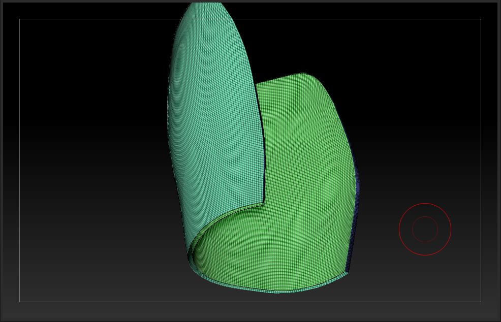

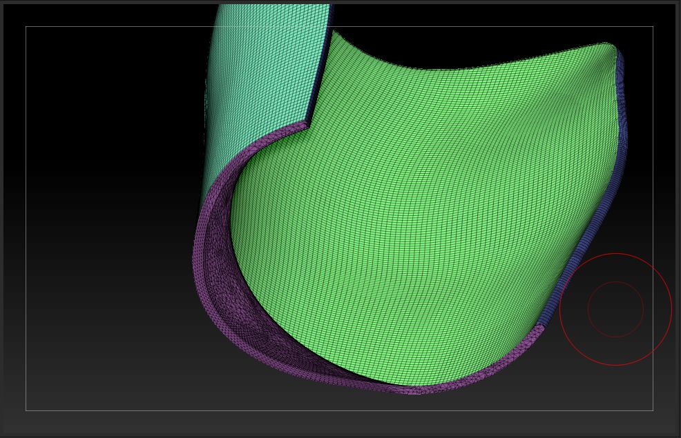

Im trying to divide a subtool into two parts for print (no other way around it unfortunately) but I’m having a bit of an issue when I want to close the holes created after slicing. Does anyone know how to eliminate the problem on the picture where after closing the holes you get a weird flat plane instead of just the closed section you want?
Close hole function will work OK most of the times but not for thin holes that is are not planar and simple.

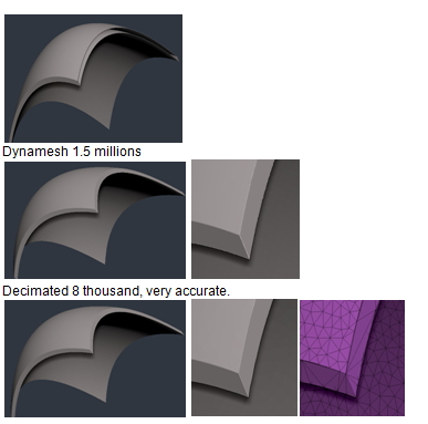

Dynamesh will solve most of those cases but will modify deeply the topology. Only a very high res Dynamesh will keep the thin edges efficiently, that can be decimated later to a minimum size
I don’t think it is the ideal solution because the deep topology change but at least works for some needs. Decimation will do wonders keeping the edges in low res. I rather would like also zremesher being able to do it for geometrical objects as always makes a mess of the hard edges, even using curve frames.

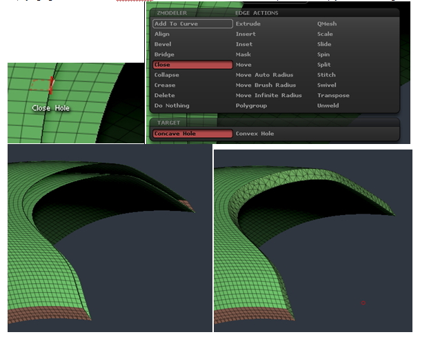

Zmodeler solution:
Ok, trying again with the new Zmodeler brush tools it seems to solve the problem. Simply select an edge with the close option active. I only have tried in this case with perfect geometry, even if the hole is quite complex. Not sure if it will work in other cases. But at least this seems very similar to your situation.
