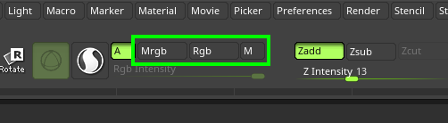

Use Spotlight and turn off MRGB, RGB and M.
2020-01-19%2014_04_18-ZBrush
Turning off material and color projection won’t change how my displacement is projected and this is not what I am asking.

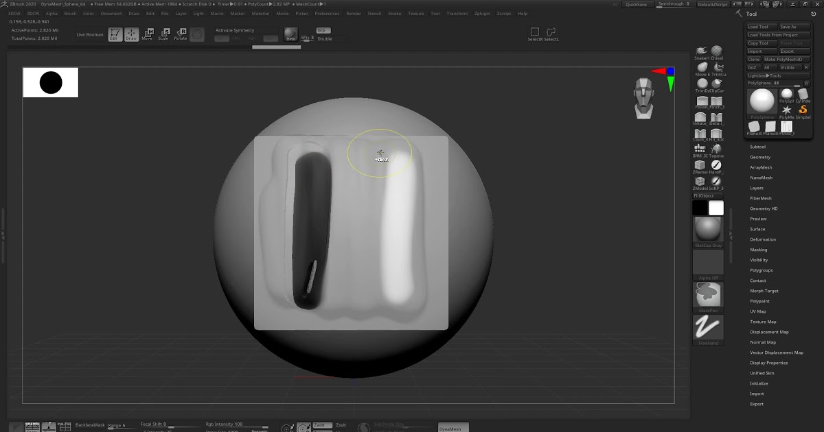

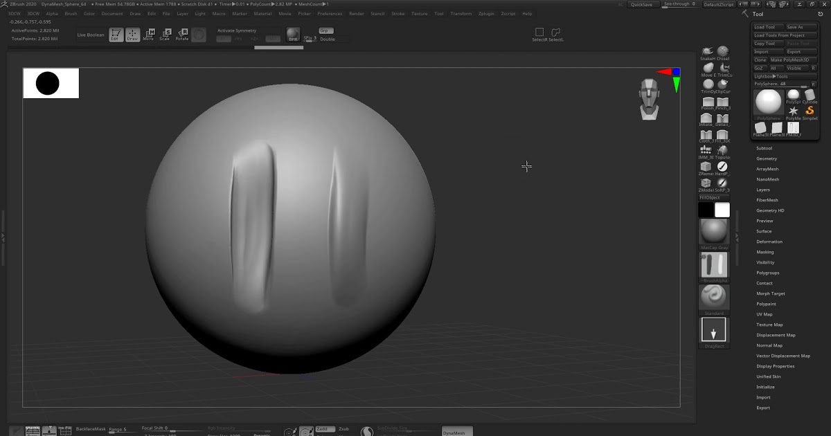

Ok to illustrate the problem a bit better here are two videos.
First one is showing the result I want to get (and the result I would get in mudbox projection). I am using dragRect where I can set the alpha and mid point.
The second one is showing what I am getting using projections in zbrush.
I want simply use the map, tell zbrush that the 0.5 value it’s my mid (do not project anything) and then everything above this value goes up and everything beneath this value goes down.
First video:
Second video:
