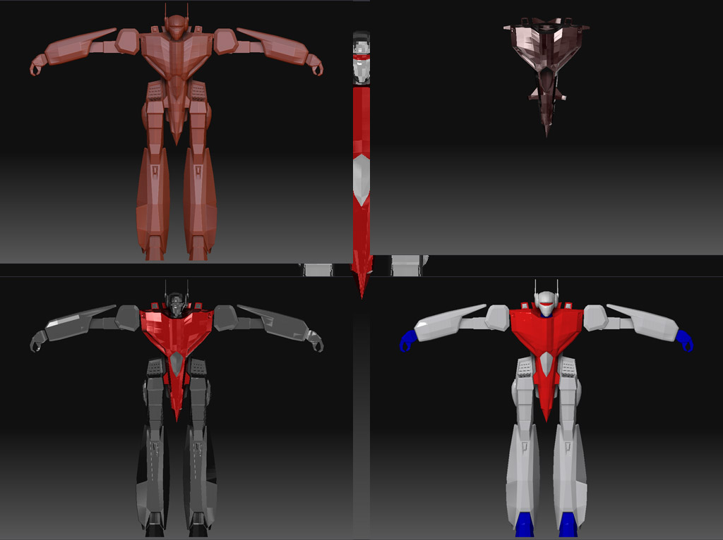

I have been experimenting some slosh. i was thinking you needed to mask groups of imported objects to change colors and all that is needed to shift ctrl click on group and fill with color. lol
[attach=56424]Example 01.jpg[/attach]
Somebody’s thinking…
