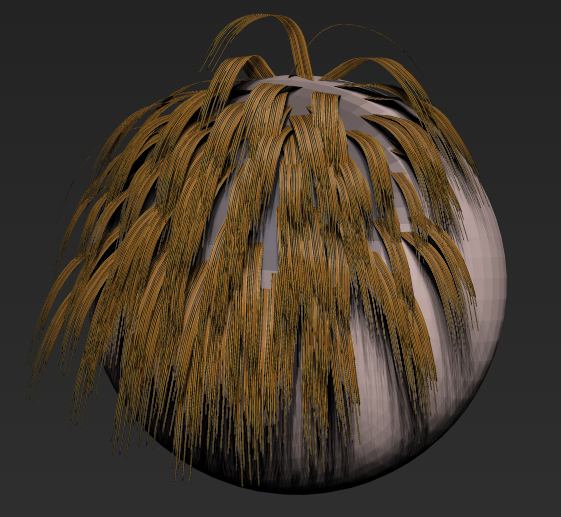

I have a quick question, is it possible to deform a insert mesh along a curve without having to use a tri-part mesh? What I am trying to achieve is a way to quickly place and deform hair cards for real-time use. The thought was if I could insert a low poly hair mesh via curve I would be able to have it bend and stick to the surface. Does anyone know of a way to achieve this in Zbrush?

You might want to take a close look at FiberMesh. With the Groom brushes you have a lot of control and it is very quick to set up, especially if you spend time to make a preset that you can then just load for a project.
If you want to use a plane rather than lots of fibers then fibermesh will do that too. I’ve attached a preset to show you how. Once you have the preview how you want you just press Tool>FiberMesh>Accept and it’s converted to geometry (with UVs in place).
