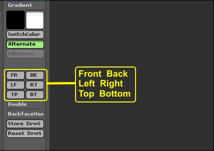

http://www.zbrushcentral.com/showthread.php?161588-quot-Axis-quot-Plugin-for-ZBrush-4r2
Don’t forget the enable perspective option too. You can get the UI tweaked nicely after a bit.
Doug has a good idea there regarding the link he provided. I would also recommend that you download and install that plugin. Those buttons come in real handy to quickly switch orthographic views. I use them constantly.
