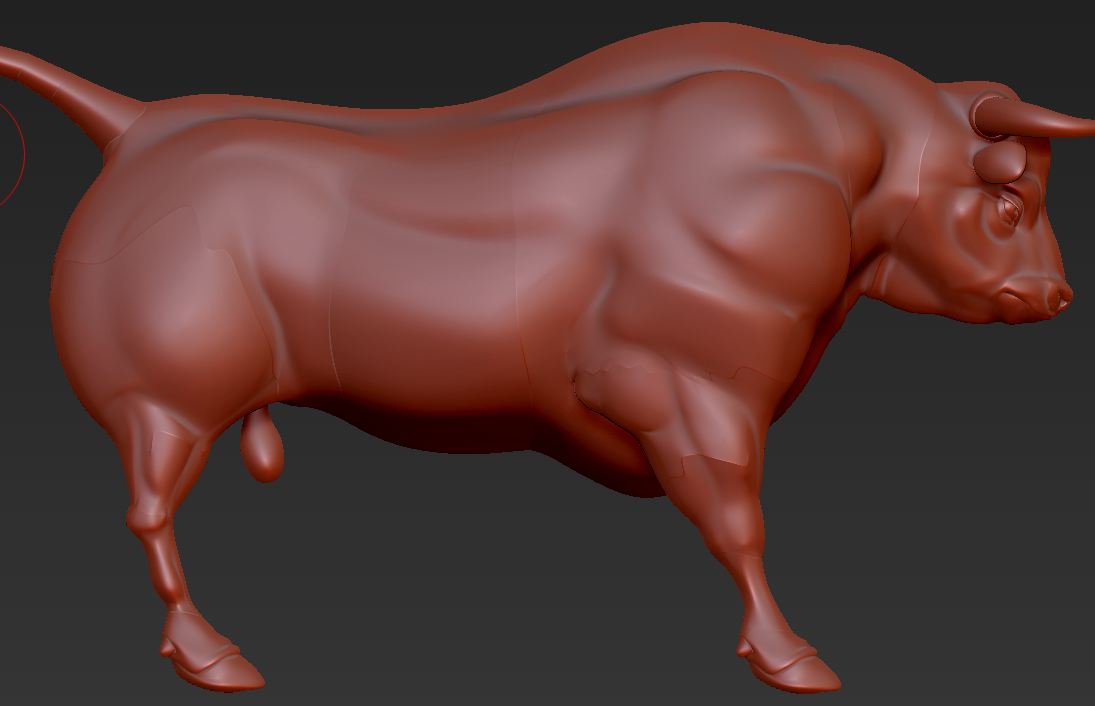

  • Bull_LoRes shows the .obj file imported to ZB. So far, so good.

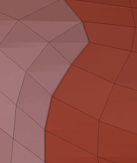

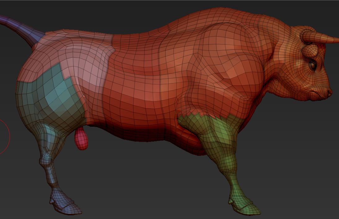

  • Bull_LoRes_PolyFrame shows the same mesh. Seam.jpg gives a close up of the “seams” that separate the polygroups. I don’t see these seams in a model created in ZB. Obviously, something is different here.
  • BrokenSeams shows how the model breaks apart at the seams if I subdivide. Curiously, if I clear the viewport, create a new document, and import the model again, the model does not break apart. However, as illustrated in Bull_HiRes, the seams show as raised lines in the mesh.
  • I thought it would be easy enough to smooth them out. No such luck. Even setting the smooth brush to an intensity of 100, I can’t smooth them out. In fact, if I sculpt a line in the model, I can’t smooth that out either, regardless of subdivision level. In other respects, the model seems to respond. For example, I can mask the torso and use transpose to move the tail.
