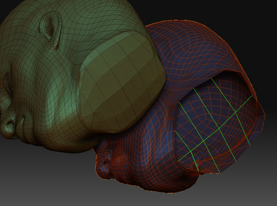

The image below shows an example where I did this after chopping off the demo head’s shoulders. The green lines are the new topology lines that I drew. I started with one that ran across the hole along the model’s center line. Then I simply bisected that line a few times in the X direction. ZBrush does construct a point in the very center of the model when you use this technique. I simply moved that point out so that the line through the middle of the mesh (front to back) ran straight across the hole.
