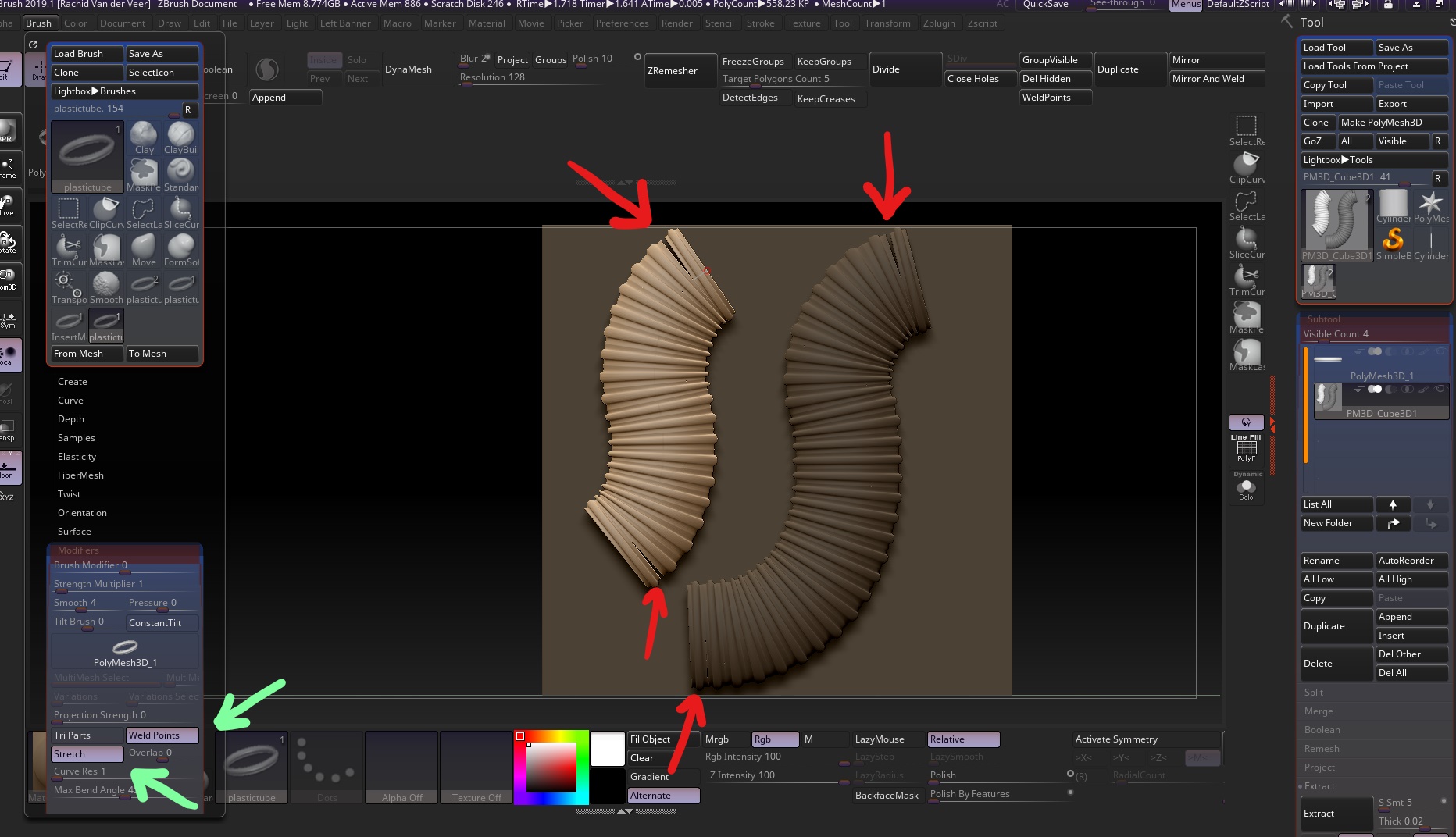

As the title says, im trying to create a tube and i have the modifiers ‘’ weld points ‘’ and ‘‘stretch’’ turned on. but for some reason the first and last welding points wont work. What am i doing wrong here ?
thanks in advance!

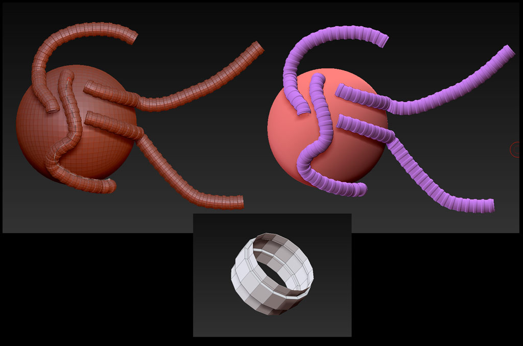

For what it’s worth, I just constructed a tube IM curve brush out this vaguely similar segment, and didn’t encounter any welding issues.
The only difference I can see would be in the construction of the segment, and the fact that I’m working as low poly as possible to start. So maybe look to those areas.

once again, thank you soooo much for your effort!
much much much appreciated!
Edit: By the way i found the issue, it was the curve res that needed to be increased.
