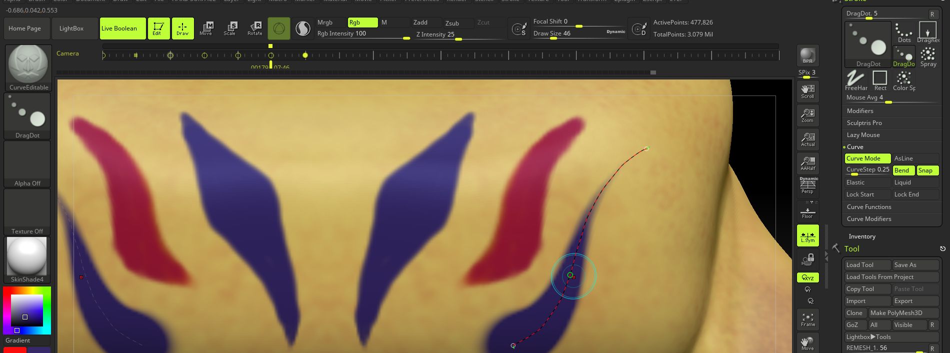

Looking for ways to create a tapered polypainted shape.
Trying to create a diamond shape with CurveEditable brush, where the ends are tapered and the middle is thick. Size is only effecting one end of the curve.
What are some other ways to do this?

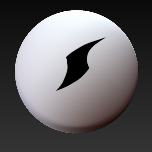

I think you’re over thinking it. Those are thick shapes, not strokes. Don’t try to do everything with a single stroke. Just paint the basic outline, fill in the middle, then refine the edge of the shape with a small brush set to the background color to “erase” any rough edges .
shape
If that doesn’t work for your painting process, then paint and apply the shapes separately as an alpha, or as a texture with Spotlight. This will give you much more control over their application.
