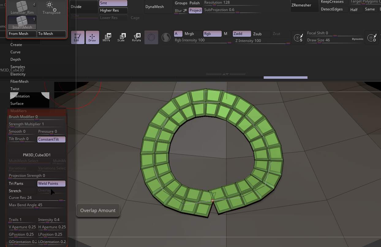

So i want my start and end to be welded like the rest of the geometry to create a full chain.
The start and end points of the curve modifier are merged into one but it isnt showing. What am i doing wrong here ?
Thanks in advance !

Hello @Rachquiat
I’m not completely certain why you’re having trouble here. I created a brush very similar to yours and am not having this difficulty.
Assuming the screenshot is showing me the correct brush settings, there are probably 3 different ways it might be going wrong:
The curve stroke isn’t actually connected to itself. Be sure that the ends are connected, and not simply near each other.
The curve may be too coarse, without enough points. Try a smaller brush size when drawing out the curve, or reduce the curve step slightly in the Stroke menu.
Other things to try:
Thank you for your reply!
i will try this out later !
