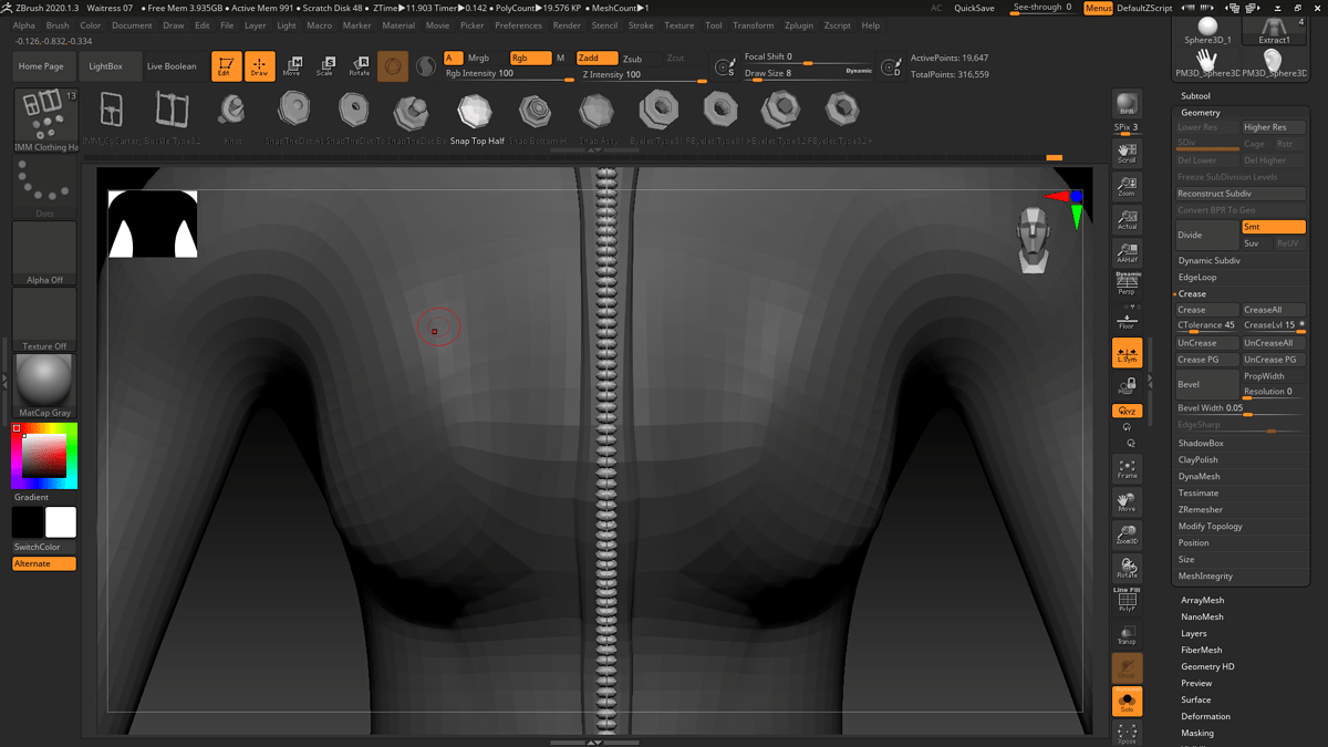

Hi there i am currently the curve and insert mesh brush to create buttons on the shirt but i am currently getting to many buttons.
does anyone know how to lower the amount of buttons or add some space between each mesh?

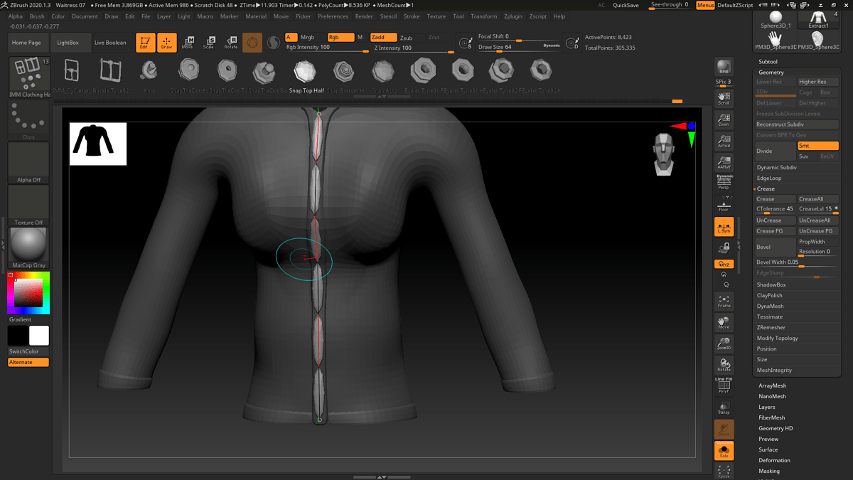

i tried adjusting the curve step but it just distorts the button mesh.
and while changing the draw size does change the number it also affects the size. it just the change the spacing between each button

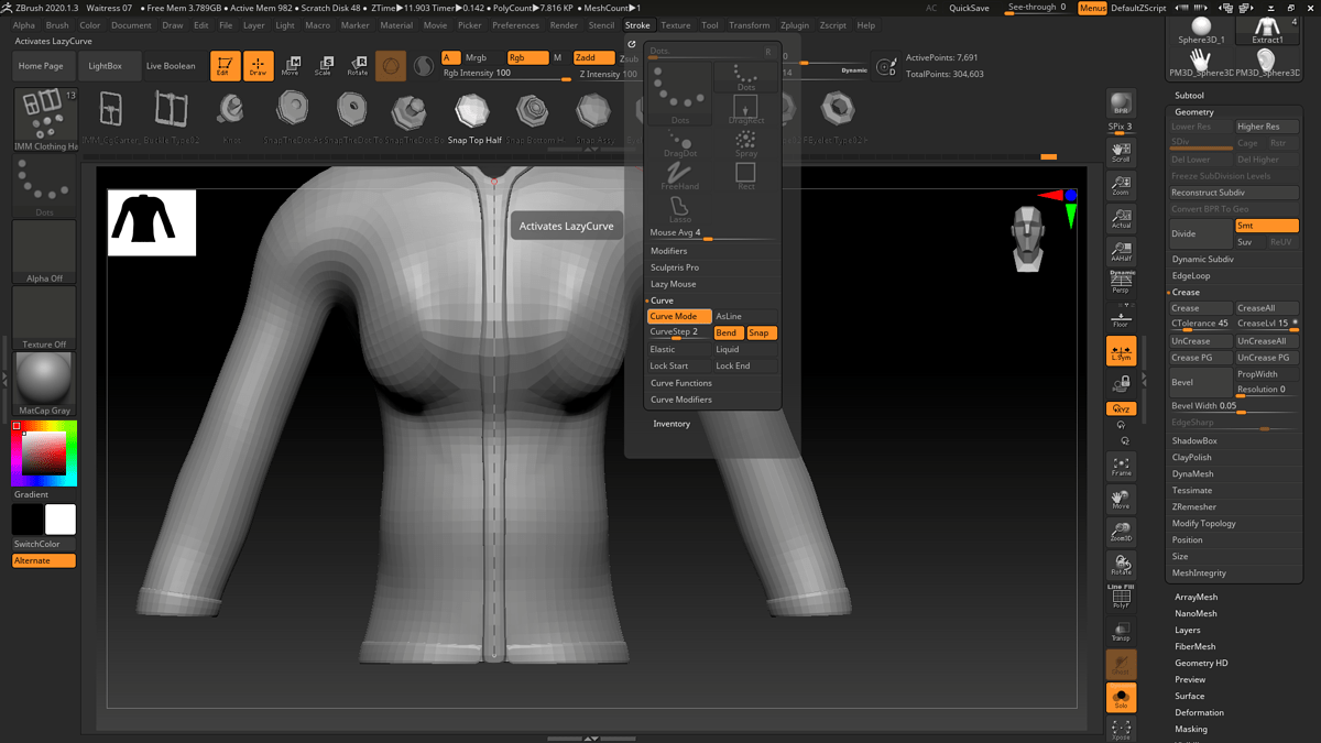

You have to increase the CurveStep slider, not lower it. Further to the right increases the space.
Can you post a screenshot of your Stroke palette?

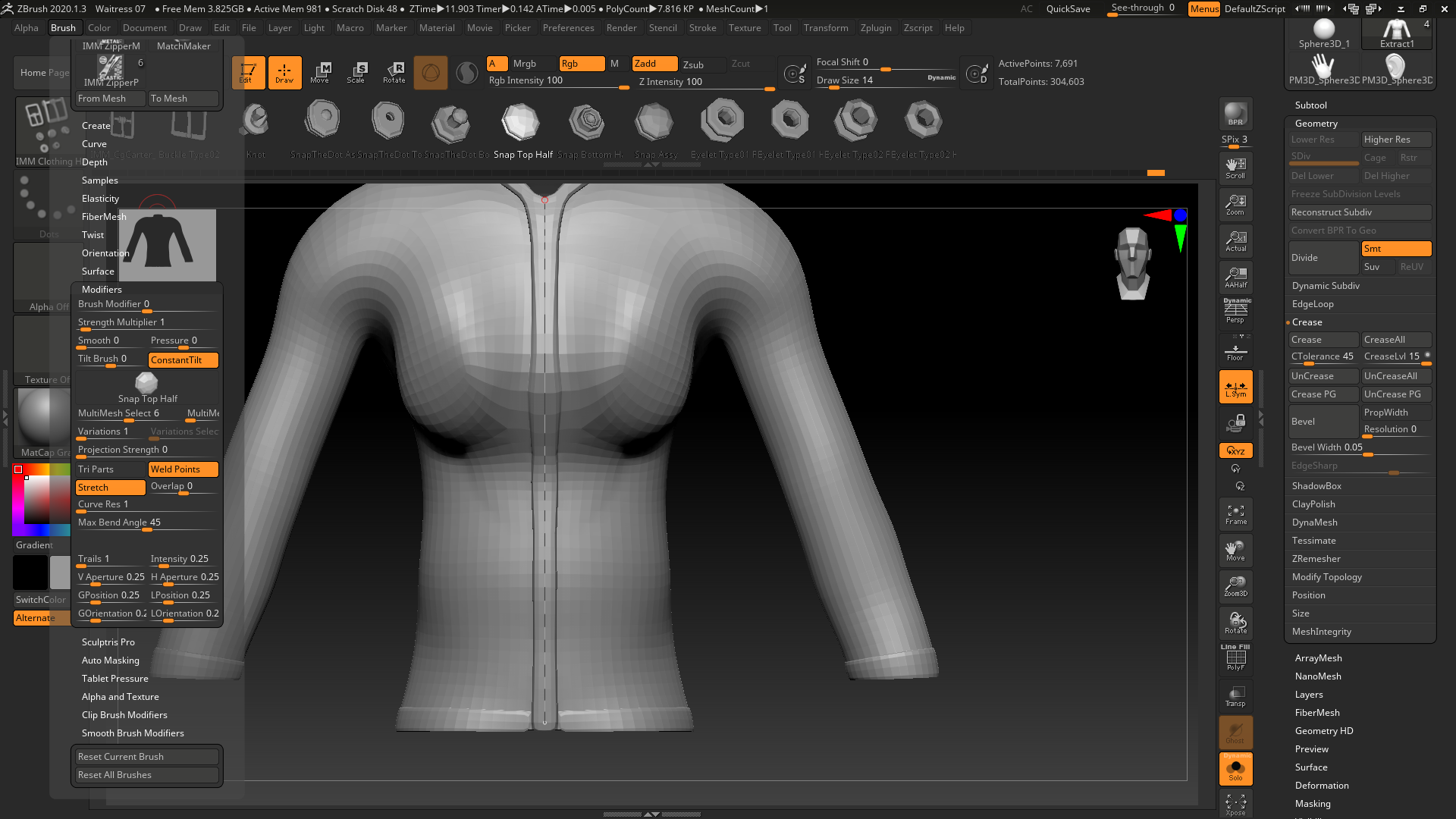

In the “Brush > Modifiers” subpalette, turn off “Weld Points” and “Stretch” beside and below the “Tri Parts” button.

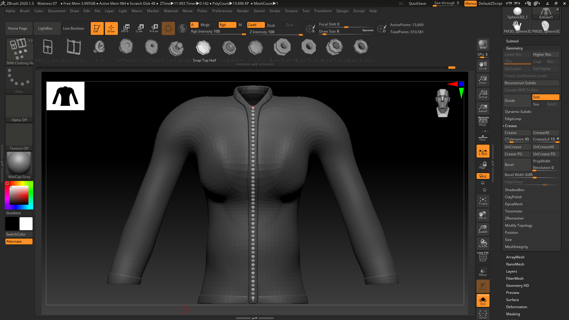

wow thank you so much.
i cant believe i actually missed that
thank you again you have been very helpful
