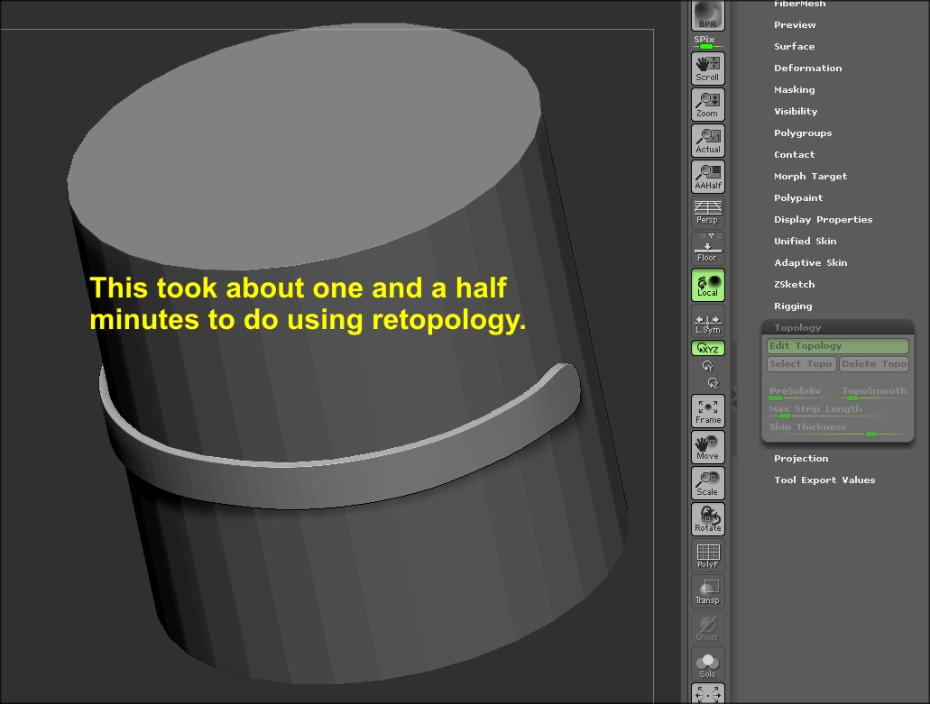

Retopology would be your best bet for a nice, clean mesh.
  1. Append a ZSphere to your mesh and select it in the Subtool list and scale and position it inside the body so it is not in the way.
  2. Go down to Topology submenu and click ‘Edit Topology’ and set ‘Skin Thickness’ to something like 0.03.
Now, just click and make topology where you want the belt. Use ‘A’ key to preview your new topology. When your satisfied, go to ‘Adaptive Skin’ submenu and click ‘Make Adaptive Skin’ which will put the new skin in your Tool palette. Click on ‘Append’ in Subtool palette and add the belt to your mesh.

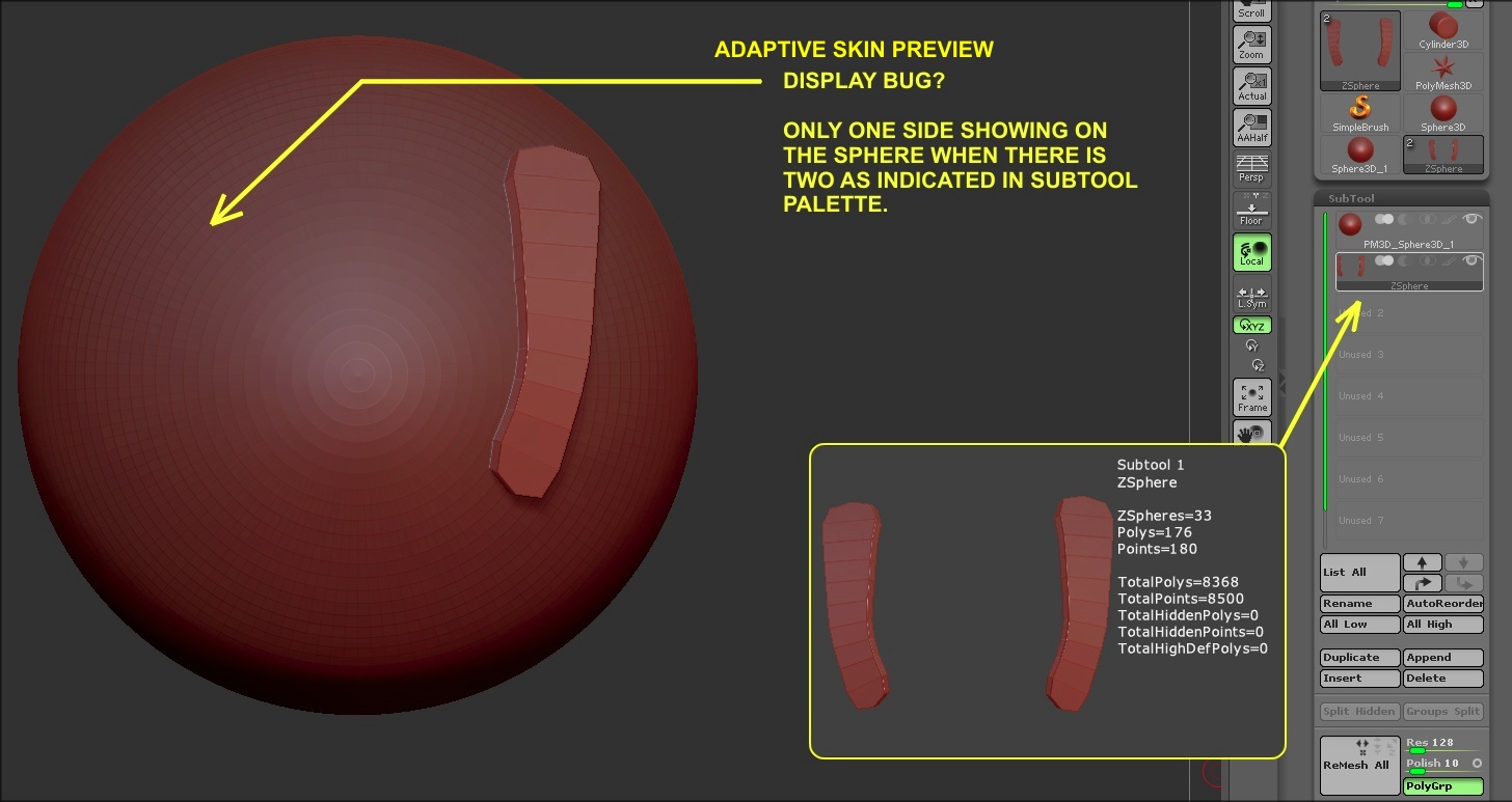

when i draw the shape of the cheek pads and press a to preview the mesh, nothing shows up — i think its because the shape does not close in the centre — anyway to get around this?
I just tried it and I see what you mean. It looks like there is a “display” bug with retopolgy and when you preview the skin, it only shows it on one side. It is, however, making the skin properly on both sides. If you press ‘A’ key and put your cursor over the ZSphere in the Subtool list, you will see both sides are there (See image below). When you click ‘Make Adaptive Skin’, it does make the skin properly. Good thing it is a display bug only. I will post this in 4R3 Troubleshooting thread also. It doesn’t have anything to do with it being joined in the centre. If your using symmetry, it doesn’t have to be joined in the middle.
After experimenting a bit more, I noticed it doesn’t do it all the time. Sometimes it works OK. If your Adaptive Skin Preview isn’t displaying properly, just check in the Subtool palette to see if the skin is indeed there by pressing ‘A’ key and holding your cursor on the ZSphere subtool.
