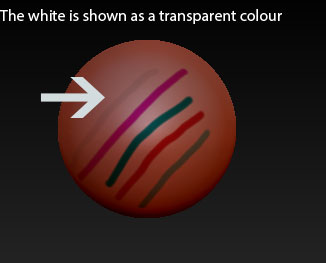

Can anyone help me with a way of obtaining the white colour in polypaint please.
I tried for instance to paint white on Matcap Red Wax, it does not work, it seems to take the same colour as the red wax.
red wax will always give anything white a red hue.
you need to change your material to something that doesn’t have a hue already in it. Basic Material for example.
