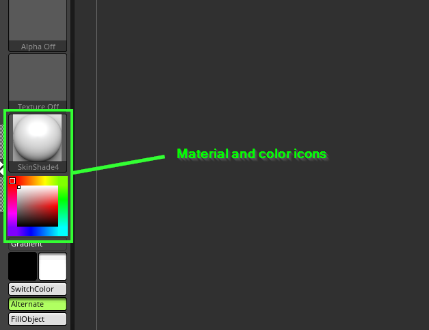

Not both at the same time. To sample the color, just click and drag the Color icon over to the subtool you want to sample. To sample the material, click and drag the Material icon over to the subtool you want to sample. Also, if you just want to sample the color only, you can just hover the cursor over the area you want to sample and press C key. These will just select the color and material. You will still have to enable “Mrgb” and “FillObject” to paste them into the other subtool.
2020-05-10 01_20_27-ZBrush
To add, you can fill the color and material on multiple subtools at once with the Subtool Master plugin and the Fill (visible subtools) command, once you have the color and material selected.
