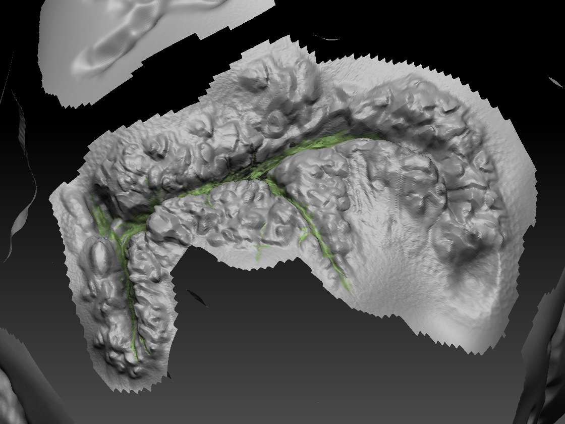

Is there a brush that can copy areas and Paste them elsewhere without it being a bunch of separate subtools
i have this area in the image below that i have to create on each crack of the model, just wondering if i have to do all this by hand or if there is a simpler way
You can copy a tool within itself if it doesn’t have subD levels. Hold ctrl while using the Move transpose line dragging in the middle circle and you will copy within the subtool. Not sure if this is what you’re looking for though.
You could do as beta_channel suggests but first create a new subtool of just the area you want to copy. Duplicate and position this however many times you need to, then switch back to your original model subtool and project the details using Project All. Store a Morph Target before doing the project so you can clean up easily.
