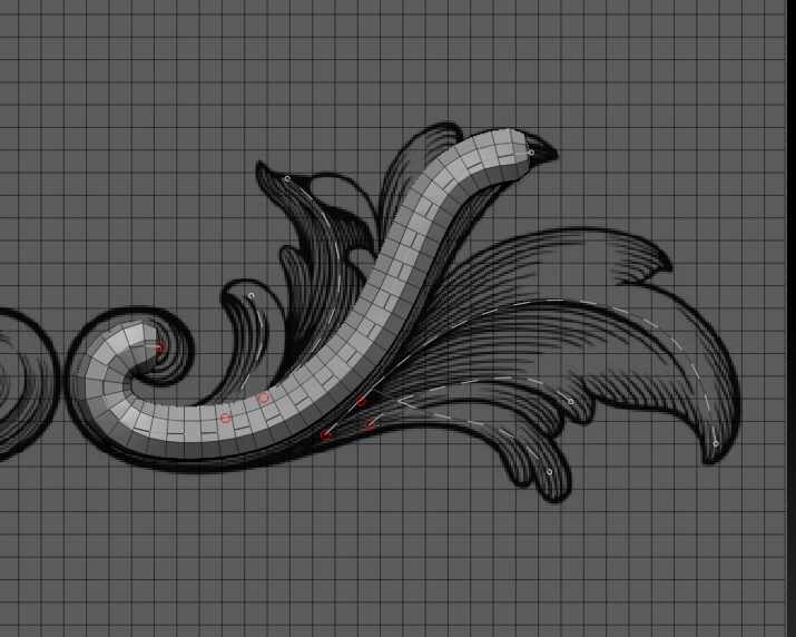

I’m attempting to begin the process of sculpting filigree. I’m using the ZRemesherGuide to create a series of rough lines that will follow the direction and curves of the filigree. Then I’m clicking on the lines that were created by the ZRemesherGuide with the CurveTubeSnap brush to make the rough outline.
The specific issue that I’m having is that CurveTubeSnap is choosing single lines to create the new mesh instead of creating the new mesh along all of the ZRemesherGuide lines at the same time.
For reference, I’m following the steps in the video link below. The specific step that’s causing me issues is just about at 34:48.
Youtube Tutorial Here
What’s happening on my side is in this screenshot. You can see that the CurveTubeSnap is only choosing one line at a time.
I know there’s a consistent way to do it because I accidentally did it before, but now I can’t figure out what changed.
Hello @FredoBear ,
If your version of the program is out of date you will need to use the Curve Multi-tube brush to do this.
:slight_smile:
That’s exactly what I needed, thank you.
