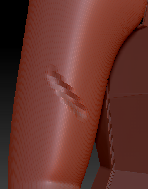

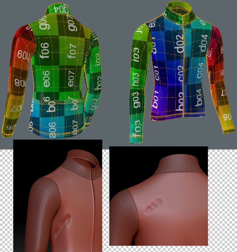

I’m trying to add wrinkles to this Modo mesh and first wondering if the mesh resolution needs more edge loops since the Standard and Damien Standard tools are not giving smooth indentations. I’ve increased the Geometry to level 4 and then 5, so any advice is appreciated, thanks
You may at some point want to increase mesh resolution further (sculpting in the millions of polygons is perfectly normal in zbrush) to do especially fine wrinkles and folds, but from what I can see in the pic you should be able to sculpt larger folds just fine at that res.
I think it’s just a problem with technique. You may want to watch some basic sculpting videos to see the basic sculpt/smooth workflow people tend to use. You may also not be making the best use of Lazy Mouse. Select the Standard Brush, and go to Stroke > Lazy Mouse > Lazy Radius, and increase that to 30 or so. That should give you a fairly long guide tether to draw out long, smooth strokes.

I’ve watched a few videos on sculpting wrinkles and will try adjusting the lazy Mouse. It looks like I just need to increase the level to 6 or 7, but gradually first building wrinkles in lower levelsjagged edges.png
Ok, the third pic does show a surface that could stand to be subdivided one or two more times. The polygons also look slightly elongated, though not too bad. For ideal results for sculpting and painting, you want evenly distributed polygons, as close to square shaped as possible.
The first 2 pics you posted show a “vest” garment that should be sufficiently subdivided for medium detail sculpting. The only thing Im seeing there is a bit of abrupt, un-confident stroke making, which could be addressed with Lazy Mouse.
Unless working for 3d print (which will not capture fine detail, anyway), the mesh doesn’t need to be perfectly smooth for sculpting, and some facets are to be expected. Thats the benefit of mutliple subdivision levels–it allows you to sculpt broad form at medium rez, that would be difficult to sculpt at high res. You only need the highest resolutions for fine detail sculpting, painting, creating normal/displacement maps, or rendering.

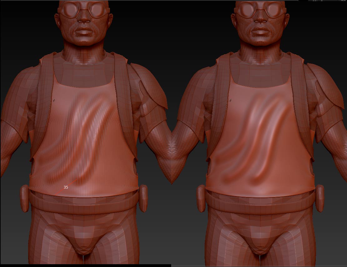

Just to illustrate what Im talking about. Loaded the demo soldier from lightbox, and easily sculpt long flowing strokes on his chest garment, even though it still appears faceted. Notice the long Lazy mouse tether (radius) I have set for my lazy mouse guide line, which aids in long, smooth flowing strokes. At high subd (millions of polygons) this faceting goes away, but it is still useful to do the sculpting at lower res, because the mesh is more responsive.
Thats why you keep multiple SubD levels, so you can work or accurately preview the model at whatever resolution best fits the situation.

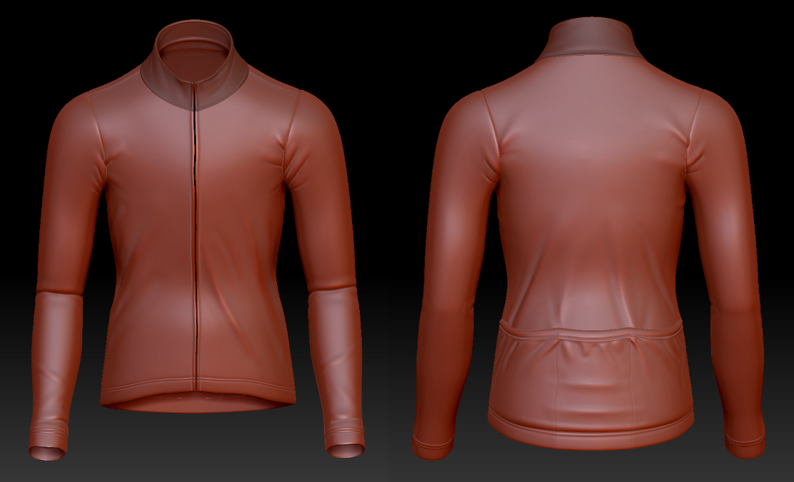

I’m fairly happy w/ these results but of course I have more to learn- I basically want to use ZB to embellish my Maya/Modo meshes for more realism and organic feelsculpting.png
