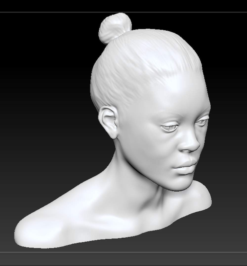

I’ve done this sculpt in 3D.
I then rotated the model and scaled it in Z to compress it into a relief. At this point it is a flattened version - but still not like a relief.

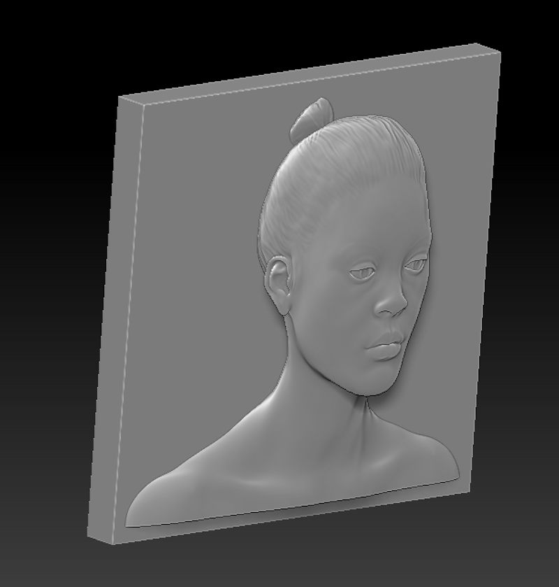

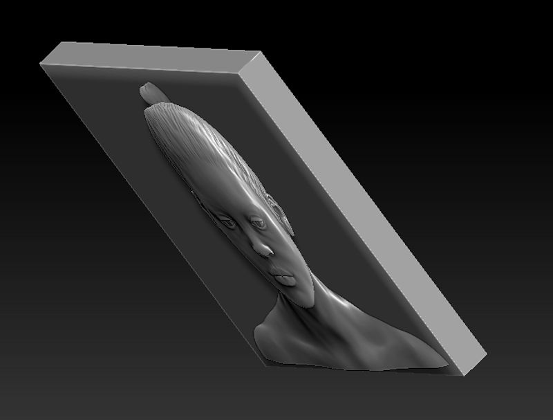

Yeah I was thinking that reliefs had to remain essentially convex. That the silhouette as viewed from the front needed to go straight back. In looking at some traditional medium relief sculpture images I see there were often undercuts and features “on the back side” but still above the background. I guess only for those carved directly (as opposed to cast).
So here are two images using the above suggestions. I’ll have to get used to the idea of the ear behind being visible :slight_smile:
I think I need to print one and see how it feels to look at the real thing. Thanks for the suggestions.
